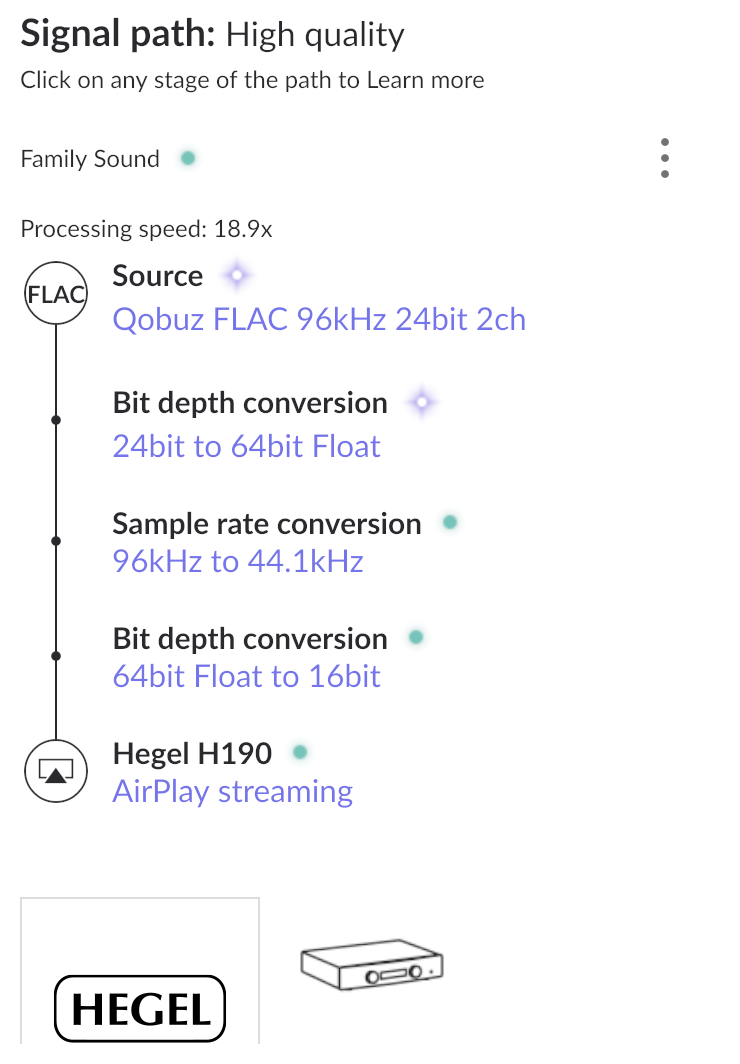

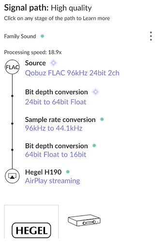

Hi, I’m presently using Roon for a Roon Ready device (a Hegel amplifier), and it appears that the signal is being downsampled for 24-bit master quality files. I can’t tell if this is because it is relying on Airplay or because I have failed to check some box or other in my setup. Any advice would be much appreciated.
Can you post a screen shot of your Signal Path so we can get a better idea of the issue. Some things to consider, in the signal path if you see anything listed after the endpoint device, then that is Roon reporting what the endpoint is doing to the signal.
This matters because some Hegel amps will resample everything to a specific sampling rate. For example,
All the digital inputs on the H190 (and H95, H120) are re-sampled to 105.47kHz.
So, Roon will report this resampling in the Signal Path but it is being done by the amp.
Does that show what you’re looking for?
It‘s because you selected the Hegel via Airplay.
Go to Settings - Audio, look for it in the Roon Ready section, activate that option instead and have fun!

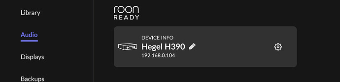

I don’t have a Hegel H190, so I cannot check myself, but I suspect that there are multiple entries for the device under Settings > Audio.
Can you double check that you have enabled the one under the “Roon Ready” section, and not one that would be under “Roon Tested” or “Other network devices section”?

I have an H390, and this is listed as Roon Ready:
