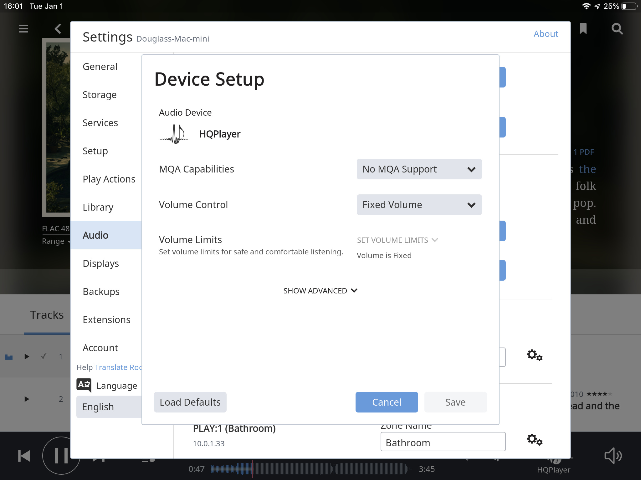

Greetings! Not to beat a dead horse as I know we have had lots of discussions on here about DSD 512 and various DACs. I was under the impression that I could achieve DSD 512 up sampling by using HQ player on a Mac using my Sonore Ultrarendu and my Oppo 205. The Mac is connected to my router directly via ethernet and Ultrarendu is connected directly to the router via ethernet and then a USB cable into the Oppo 205s ayncronous USB port. I have no switches in the network and ethernet runs are all very short 2-3 ft. I have the HQ player settings on 44x512, but no matter what I set them to I am only seeing DSD 256 on both HQPlayer and Roon. What am I doing wrong? See screenshots of my settings.

I see you have DoP set in HQ Player. Maybe uncheck that?
Hi Jesus! I tried that a few times and just got horrible white noise when I hit play!

Thanks all for the help. Unfortunately even when I’m selecting 44.1 x 512 With or without DOP selected,I am still getting White Noise. I don’t have access to a Windows computer but I do have an old parallels accounts that I would have to upgrade so perhaps I could run windows on my Mac and try 512 upsampling that way. That may have to be a weekend project.
