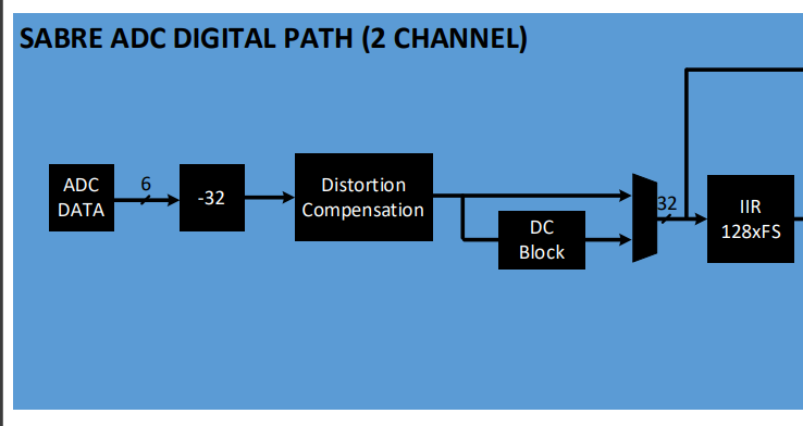

The chip can also output raw data using 7 GPIO data pins, so I doubt it’s a 1-bit modulator. Also, the signal path from the datasheet seems to suggest it’s actually 6 bits:
Regardless, decimating to PCM doesn’t seem to do much damage.

That doesn’t tell how many bits the modulator is, just that the data is transfered in chunks of 6 bits. Remember that it has 4 ADCs inside. Out of 7 raw output pins one is clock and six are used for raw data for all the 4 ADC channels.
It can also output max DSD512. It has 5 pins for doing DSD output, one for clock and 4 for data for all the 4 ADC channels.

It is just unnecessary, and you can see from the datasheet how much they cut corners. It would be likely so much better if you would just take it’s raw data or DSD data instead of PCM output.
It has also configurable DSD dither level (5 bit value)…
Don’t try to use Cosmos ADC for measuring phase responses though, since those IIR decimators will introduce phase shifts. And the last stage FIR is nothing to call home about, with max 115 dB stop-band attenuation. Reason seems to be that the filter coefficient precision is max 24-bit. But afterall, it has been designed for recording music, not for making measurements.
