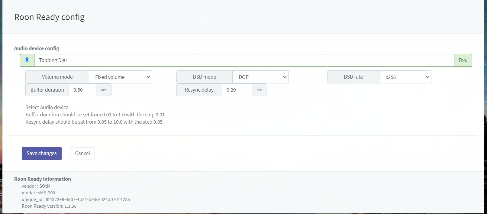

Ok, so making some kind of progress here. Not sure if it made any difference or not, but I noticed there were some upgrades to be done for SMS 200. So I performed these and then checked on the Roon section of Euhenansa and it now showed my DAC. Was able to change DSD128 to DSD256 in the DSD rate field, so that’s a result.
I can also now use sample rate DSD256 in DSP on Roon now, previously the max was DSD128.

Well bizarrely after making the changes to the SMS 200 on the website, eg changing DSD rate from DSD128 to DSD256 as per screenshot above, things have actually got worse using HQP :grinning:

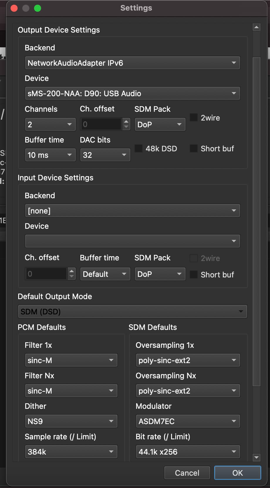

I’ve tried HQP on Roon, and also just the HQP desktop with the settings below, and the distortion is even more pronounced.

I changed the buffering from default to 10ms, and set both the SDM Pack and my SMS 200 to be DoP. I have played music at these settings for about 45 minutes now and haven’t heard any distortion.
So fingers crossed that it stays that way for a while longer, and perhaps we can then say it’s solved.
So after approx 10 hours listening I think I am reasonably confident in saying that HQP works in my system without distortion.Perhaps 3 or 4 times over that period a song would briefly stop for a second or so, but that can probably happen when streaming music and I guess it’s just the computer taking a spike, or perhaps a glitch on the network. Certainly not a showstopper.
I’m using these settings.
