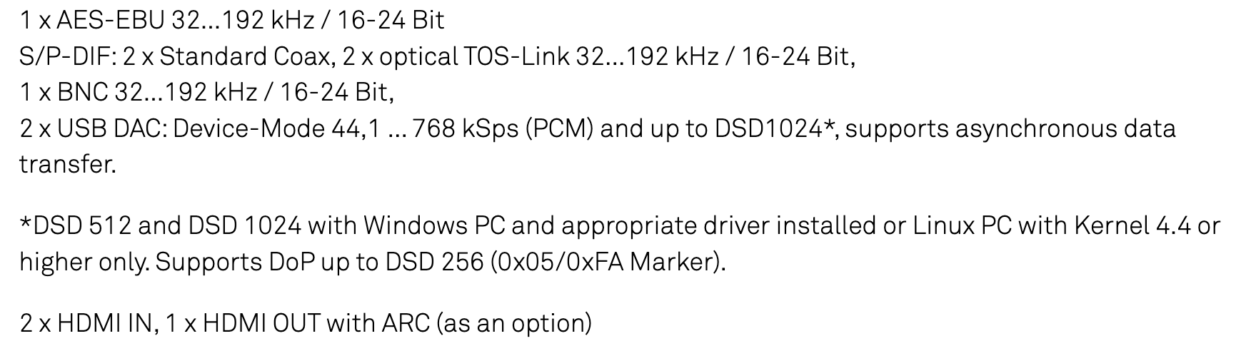

You’re right, that’s what T+A’s spec says. That’s why this morning I sent an email to them asking. But even if it only works via USB, the new Node Icon could be a remedy (depending on what it tells of its capabilities via RAAT) because it offers USB as digital audio output. The latter will, with a firmware update, also be true of the new ‘normal’ Node (N310) although it does not ‘understand’ DSD itself.

But as @Menzies said, your T+A device does not support DSD over coax, it only supports DSD over USB:
https://www.ta-hifi.de/en/headphones/headphone-amplifier/ha-200/
