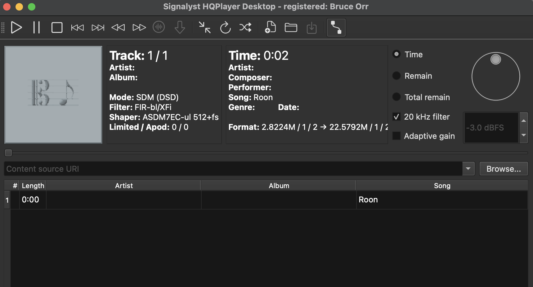

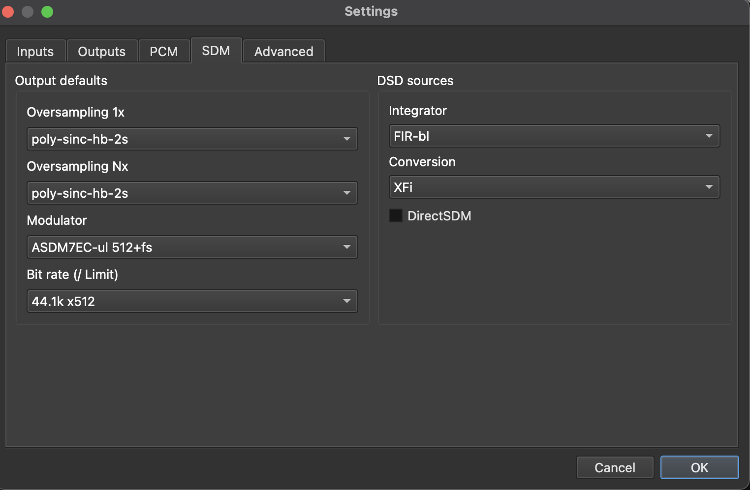

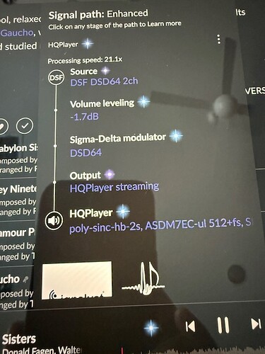

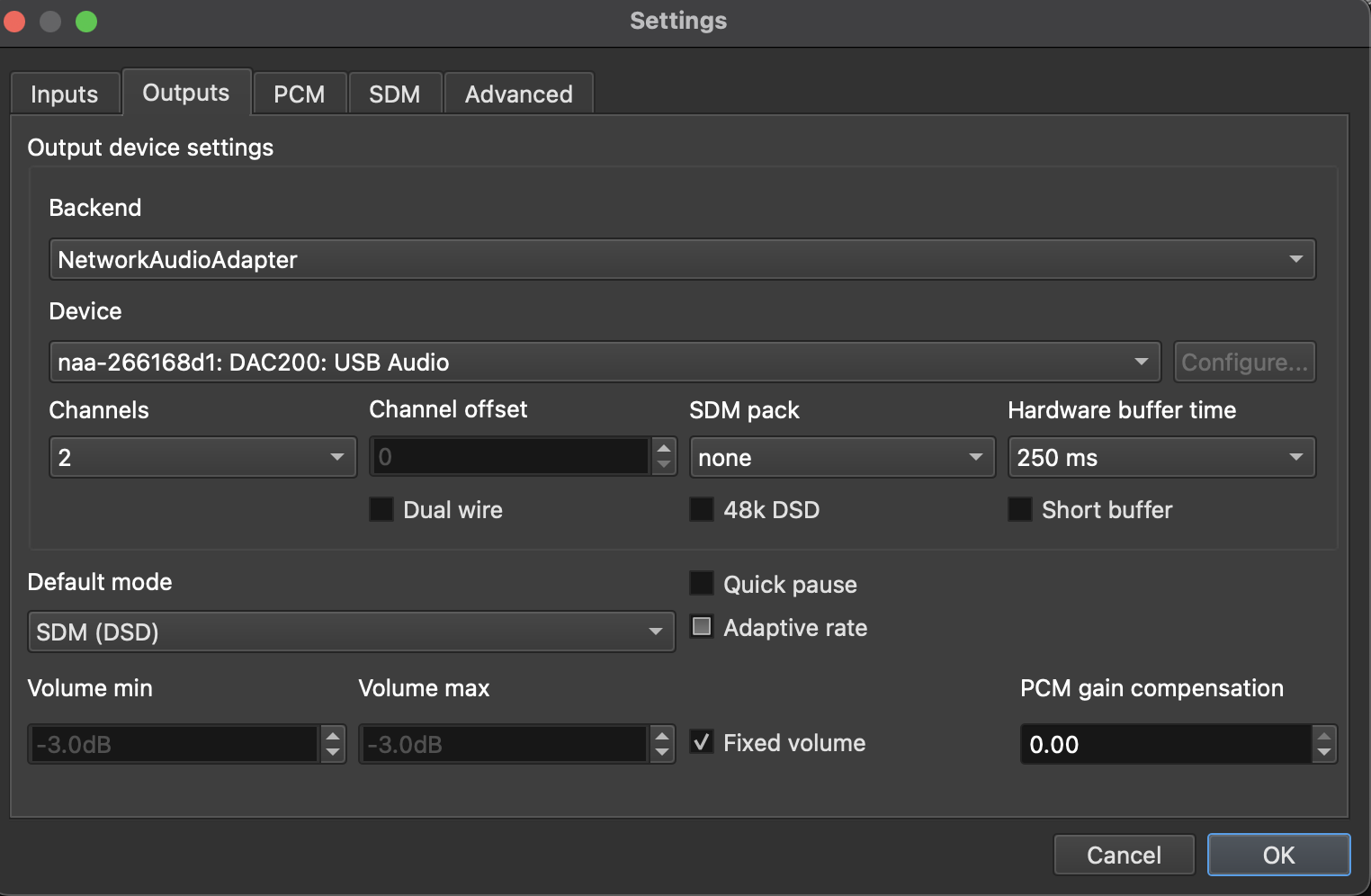

Hi Jussi. Thx for reaching out. Yes, I meant adaptive rate. Here are screen shots of my HQP setup. I have been getting drop outs with 48DSD so it’s not being used here. Also I’m using DAC correction. The homepage shot shows what HQP is processing when trying to play DSD64. Also included a screen shot of what roon shows is playing when trying to play the same DSD 64. T+A 200 also displays DSD512 when we’re trying to play native DSD64.

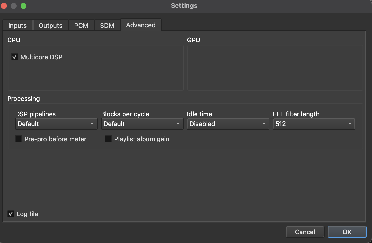

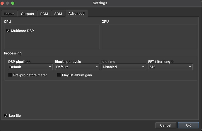

One major problem here. You have volume leveling active and as result Roon is doing unwanted DSP on the DSD and not passing it bit-perfect to HQPlayer. So as first thing I would disable this part.
I also recommend to leave “Multicore DSP” in HQPlayer to grayed (auto).

I’m not sure what you want to do. Yes looks correct upsampling DSD64 to DSD512, which is higly recommended, since playing DSD64 straight to a DAC is not recommended in any case.
But for Direct SDM to work, you need to make sure matrix processor is disabled. Which means you won’t have DAC correction. But this part is not clear from the above screenshots if you are trying to include DAC corrections for the DAC 200 or not (HQPlayer Client screenshot would be more descriptive in this respect). These DAC corrections of course will add their own share to the processing load though.

How does Roon signal path and HQPlayer playback information look like?
