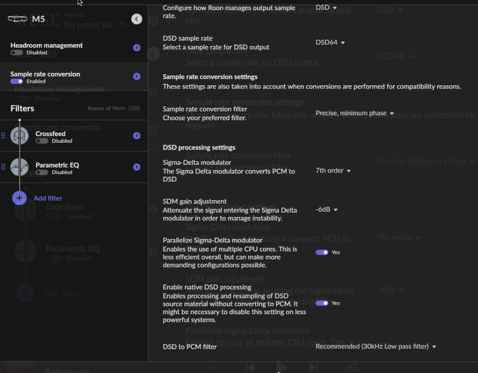

Firstly, to be honest, I do not know much about dsd upsampling, hence why i’m posting. I have been experimenting and find things to sound quite good with the following setting (-17db ufs):
I have set conversion filter to precise minimal phase based on roon website - I mostly listen to electronic, studio based recordings. I have just now enabled native dsd processing.
At dsd64 things seem quite stable, although tiny ‘click/pop sound’ when first starting playback (doesn’t happen thereafter (progressing tracks etc). At 128 things start to become unstable (random pop/clicks).
I have stuck with dsd64 and I am aware that conversion affects MQA, but not so worried about that - I do not rate MQA. Please might people confirm whether or not dsd upsampling is, in reality, beneficial when using Tidal and maybe explain if I should be employing native conversion (I seem to notice great improvement when enabled)? Basically, am I delusional :slight_smile: ?

This could be because the DAC has to adapt to the signal. With some DACs, you can hear such sounds when the signal switches between PCM and DSD.

Mac mini M1 is great for DSP up to DSD256, I use one for HQPlayer. I don’t know how efficient Roon’s implementations of the relevant filters and modulators are, but for sure the M1 has a lot more compute power for this purpose than a 2012 mini.
Regarding your findings with DSD: most DACs (not all) are internally delta-sigma, and use internal upsampling filters and a modulator to convert from PCM to SDM (sigma-delta modulation), which is what the DAC needs. An external computer has a lot more compute power so it can implement better filters and modulators and send its SDM output as DSD directly to the DAC chip, bypassing the less powerful internal filters and modulator. Now, the internal filters and modulators are designed specifically for that DAC and may get benefits from that that the external filters and modulators don’t. That is, YMMV.

When looking at your signal path in both scenarios, what are the processing speed numbers?
Seems you’re using volume leveling, which may be dropping your processing speed, so turn that off for another test, also.
Report back with screenshots and your findings, please!
Common issue. You might want to convert to DoP, which does nothing to degrade the signal, and keeps this from happening. The only disadvantage is that it requires twice the network bandwidth.
