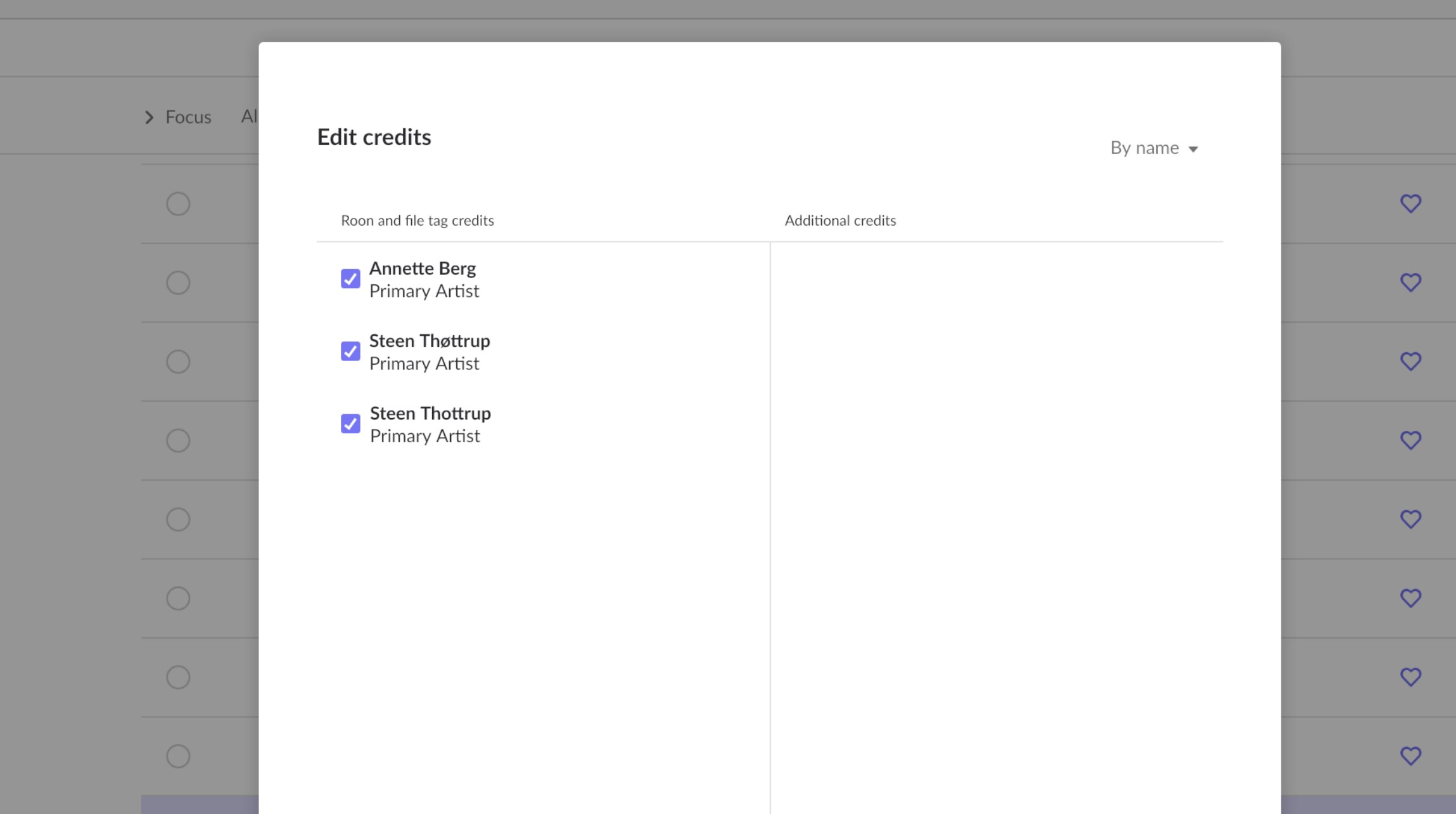

#2 Roon database does not merge artists who have unusual characters in their name. For example, artist Steen Thøttrup and Steen Thottrup are two different people in Roon:
While in the above case, if you were to click on the Steen Thøttrup (the correct spelling) name, his page shows correctly.
That is not the case with the artist Cécile Bredie whose correct spelling goes no where.
While incorrect spelling goes to the right page.

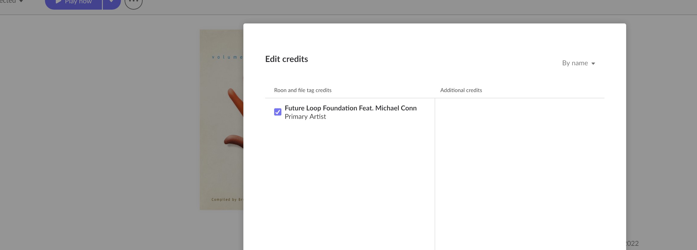

#3 Roon database does not distinguishes between 2 artists when there is a “feat.” or “featuring” between them but sees it as one artist. For example, the song has an artists “Future Loop Foundation feat. Michael Conn”, and should be listed as two primary artists as Future Loop Foundation and Michael Conn separately, but instead, it shows like this:
You can merge duplicate artists, but you may also want to check the file tags first. You may have the artist listed as primary artist and artist.
When feat. is used, both artists are part of the same string and are seen as a single artist. This shouldn’t be used in titles nor include parentheses etc. You can change this if you wish:

I am aware of merging. But if I have 3000 songs in my collection going one by one is unreasonable. I was hoping the software can sort this for me, as in merging duplicate artists by itself, and making a separate artists if it detects “feat/feat./featuring” somewhere (as in before the static feat is artist #1 and after it is artist #2.
The feat part (at least in my case) goes in tags, not in the name of the file.
Again, I understand what you are saying and understand there is a manual way to sort this out but we are all using Roon because it does all of this for us, and if we wanted to deal with every song manually, we can still use Winamp.
