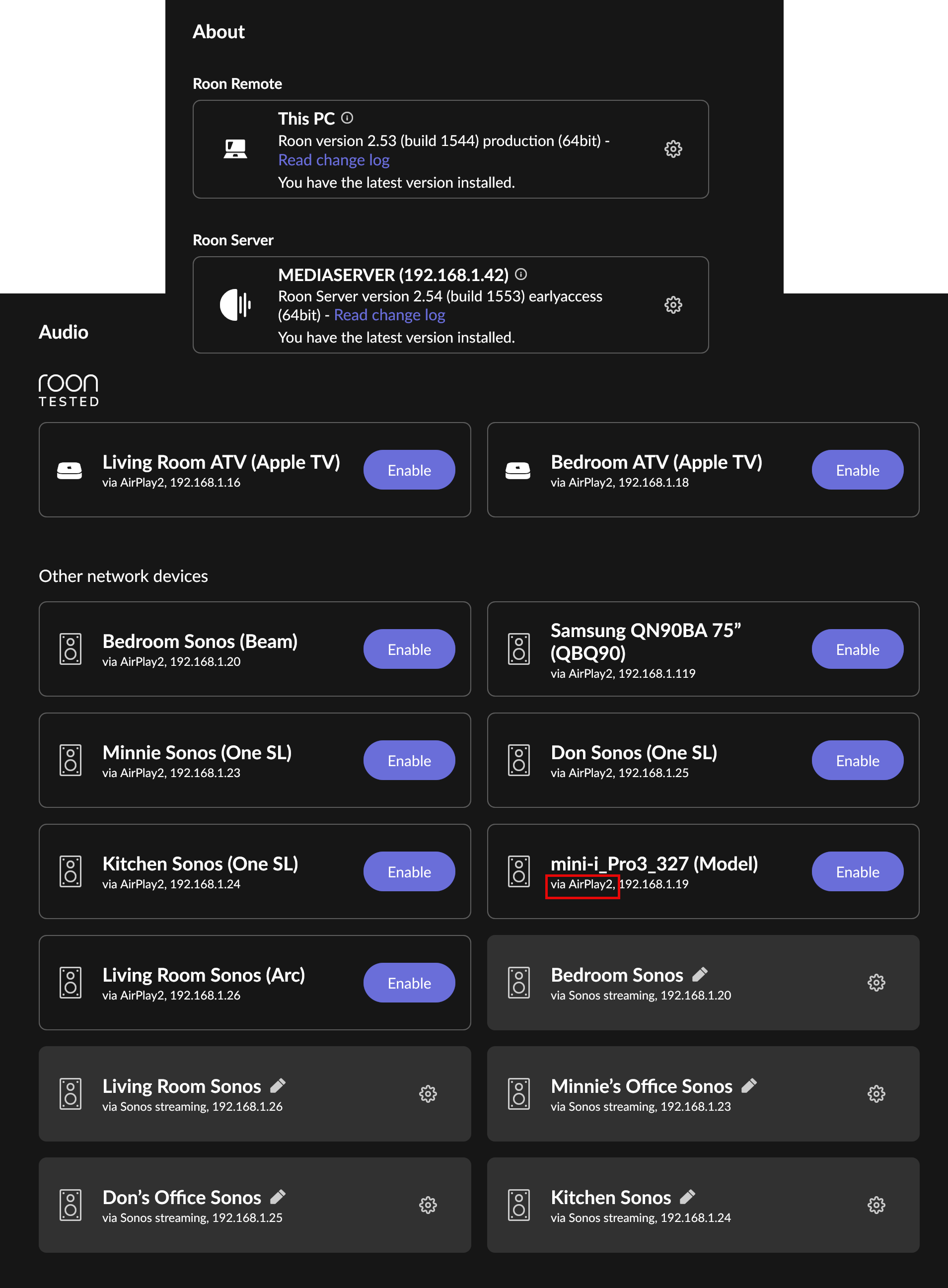

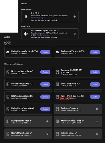

Today I tried the Matrix DAC, but Roon wouldn’t show the Matrix DAC in my Zones. I rebooted the Roon server app, still no luck. Then I restarted the machine at least 2 times trying different scenarios of killing other apps on that PC. One small correction, Roon only saw the DAC as an AirPlay device when the Zone I normally use is under “Roon Ready” (not the AirPlay instance).

Perhaps I spoke too soon. EA build 1553 was good for a bit. I didn’t use it for a while and now it is not showing my DAC again, just the AirPlay one, which I don’t use.
I rebooted my router to test the other user’s claim, and for now, it is back. I’ll have to check in sometime to see if I lose it again.

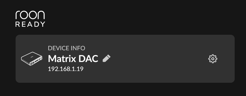

This screenshot is after the reboot of the router.
Small update, Matrix Dac still visible this morning (after the router reboot). Not sure if Roon wants to do logging, but I’ll keep testing
