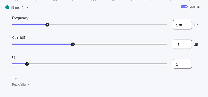

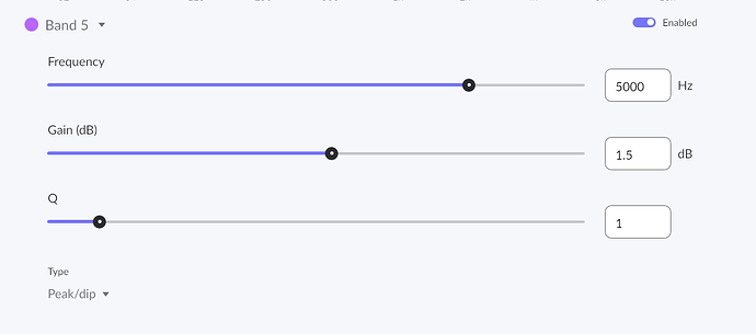

These are my roon band settings:
So what I would like to do is just type these 6 numbers into hqplayer. Is that possible?
There are two ways:
  1. Just enter the parameters in HQPlayer pipeline configuration:
iir:type=peak;f=100;g=-5;q=1,iir:type=peak;f=5000;g=1.5;q=1
