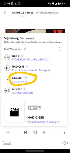

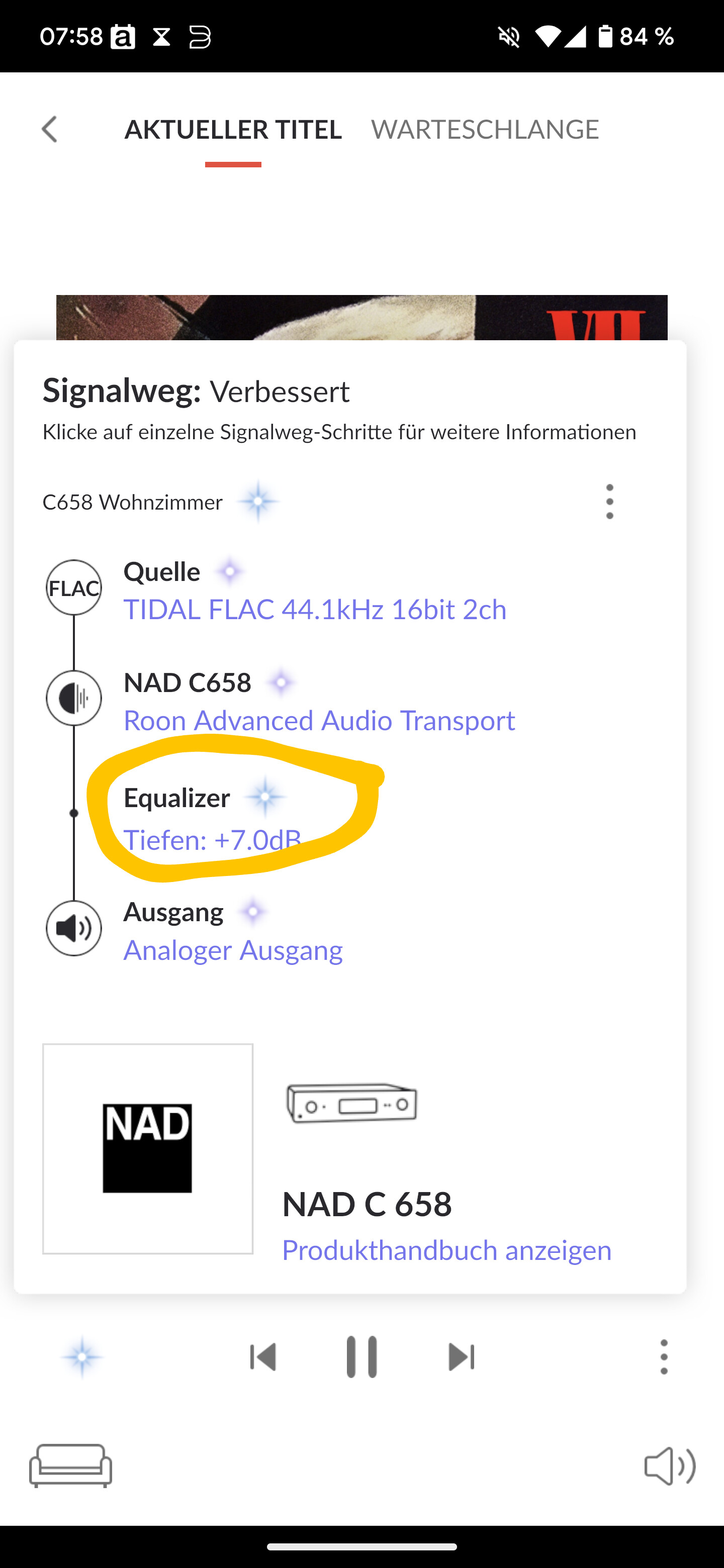

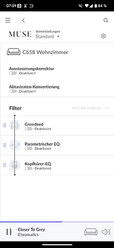

I have a question regarding the signal path. In my case it shows an active Equalizer. I can’t remember that I have set it. And it seems I can’t remove it. When I go to the DSP settings all EQs are inactive.
See attached screenshots. I also deactivated DIRAC, but the EQ still shows up. Also there is no EQ setting in the Blue sound App. Any idea what this is about and how I could change it?
Thanks.
Frank
This is occurring on the C658 and not within the Roon domain.
Are all DIRAC filters turned off. If so, maybe power cycling the C658 could help
I re-checked the BluOS app and found the setting. It was inactive but there was a value set. Setting it to 0 it was also removed from the signal path. Thanks!
