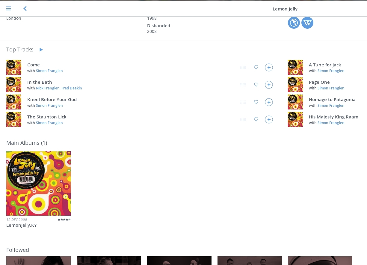

I have a Lemon Jelly comp CD that actually comprises 3 separate EP releases. In Sonos:
In Roon:

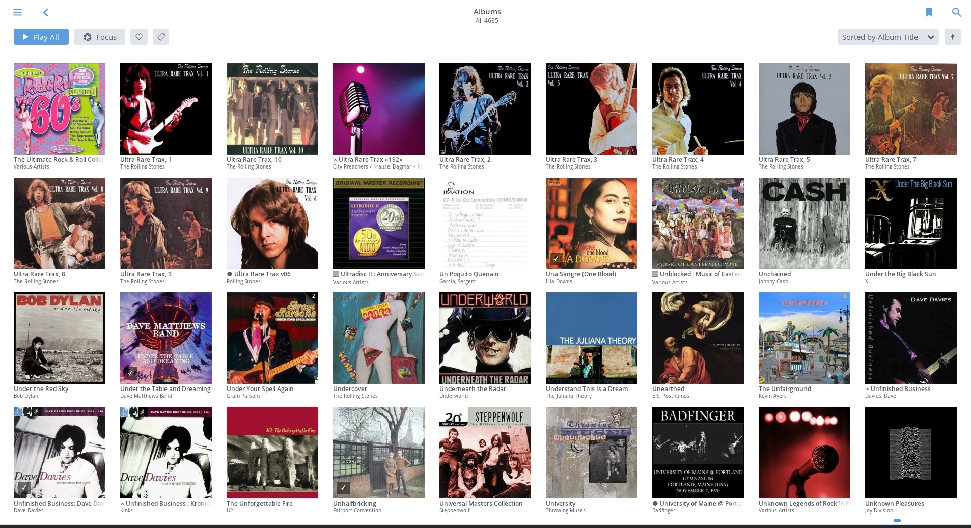

Here I’m in Sonos, looking at all my albums as a whole. Note the sorting-change when Sonos hits the relevant prefix symbol:
Here’s the same search in Roon. Note that while Roon shows my prefix symbols, it ignores them wrt sorting.

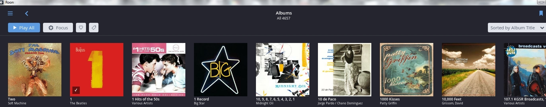

A little more tinkering around reveals some further issues with the search engine, and also with standard symbols, such as the # sign, not just non-std symbols.
The problem with the # sign negatively impacts the way Roon’s custom-culled meta is displayed (this is not about my meta, or my collection). I’ll stick with the Sonos-Roon comparison pics…
Given: The Big Star album #1 Record, the Lennon song #9 Dream, and the Dylan song Rainy Day Women #12 & 35 all have (semi-iconic, even ) # signs in the title. At a minimum, they should display properly, and be searchable as well.
All albums alphabetical, Sonos:
Same in Roon:
