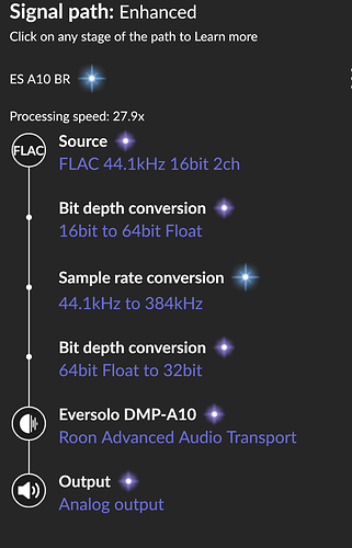

So I feed my A10 via the USB-B in sourcing from a NAA via ROON and HQP. When I do this, I receive no subwoofer output at all. I have checked every setting I can think of including the DSP setting and setting up the HPF and LPF and still nothing.
I have a REL sub attached to the A10 via the RCA sub-woofer outs and works fine when “Internal Player” is selected, USB-B in, no sub via the RCA subwoofer outs.
I have an A8 as well, but that is setup differently where I am talking the output from the AMP full range to the REL via their umbilical cord and setting the LPF in the REL.
Am I missing something in the A10 or is this by design? One of the reasons I purchased the A10 was to leverage the subwoofer outs but seems that only applies to “Internal Player.”
Also, if I scale w/ in ROON only, either PCM or DSD, same behavior, no sub out. Lastly, playing any native DSD file, no sub out.

Where I am disconnected, ROON does the scaling and sends the stream to the A10 and the A10 should play the stream as if it was a native file at higher bitrate? I realize not a HQP issue, just asking…
Thanks
Yes, that’s the case… The device doesn’t know how the 384k data came to be.
Maybe it’s capped at 192kHz, will test…
