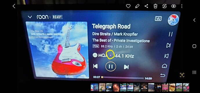

When streaming MQA I get a red dot behind MQA, I see in the manual there should be a green or blue dot. Any idea what the red dot represents? I am using analog out to preamp. This is definitely coming from Roon as if streaming from the ES app a blue dot appears. Just curious about it, does not seem to alter the audio quality that I can hear anyway.

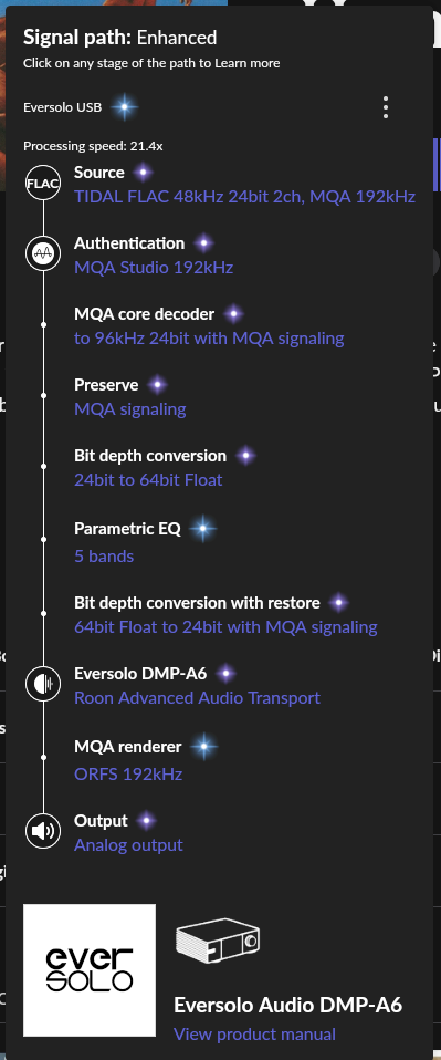

What’s your Roon signal path show?
All is correct. It’s receiving a decoded MQA signal which it will then perform the final rendering. It won’t be the colour you expect as it’s not doing the whole process. It shows MQA on the display and the incoming rate.
Turn off the Parametric EQ.

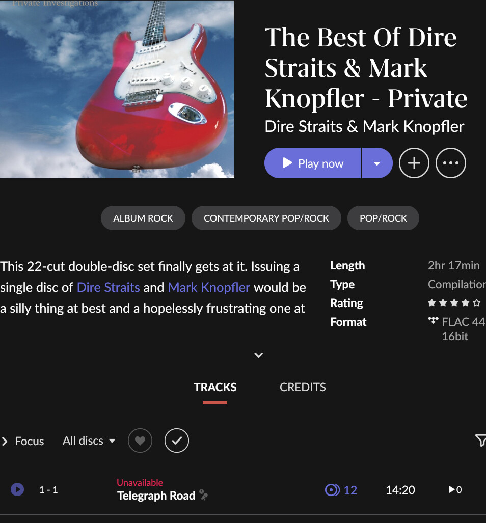

maybe an indication it’s Unavailable?
Why it’s working as it should you can see that in the signal path. He’s obviously using peq for a reason.
That did it, turned off and the dot turned to Blue. Could really care less what color it is, it was just curiosity more then anything. Turned the EQ back on, as it sounds better. Thank for your response.
The light just indicates if the Eversolo is doing the full MQA decode and render, green is MQA, Blue MQA studio, red means it’s receiving a decoded MQA signal (they don’t list that in the manual). Roon shows the DAC is doing the additional MQA rendering as the last stage called ORFs.
