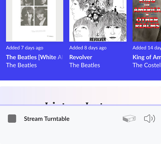

First screenshot is the bottom of the Roon screen showing the Stream turntable playing. Note if you click on the banner nothing happens except for the square which stops playback and the volume control. It won’t expand “full screen.”:

So there are a lot of limitations and RooPlay seems much better integrated. I already owned the turntable so for me this is a bonus, but if you’re starting out you can probably get a lot more turntable for your money using RooPlay
