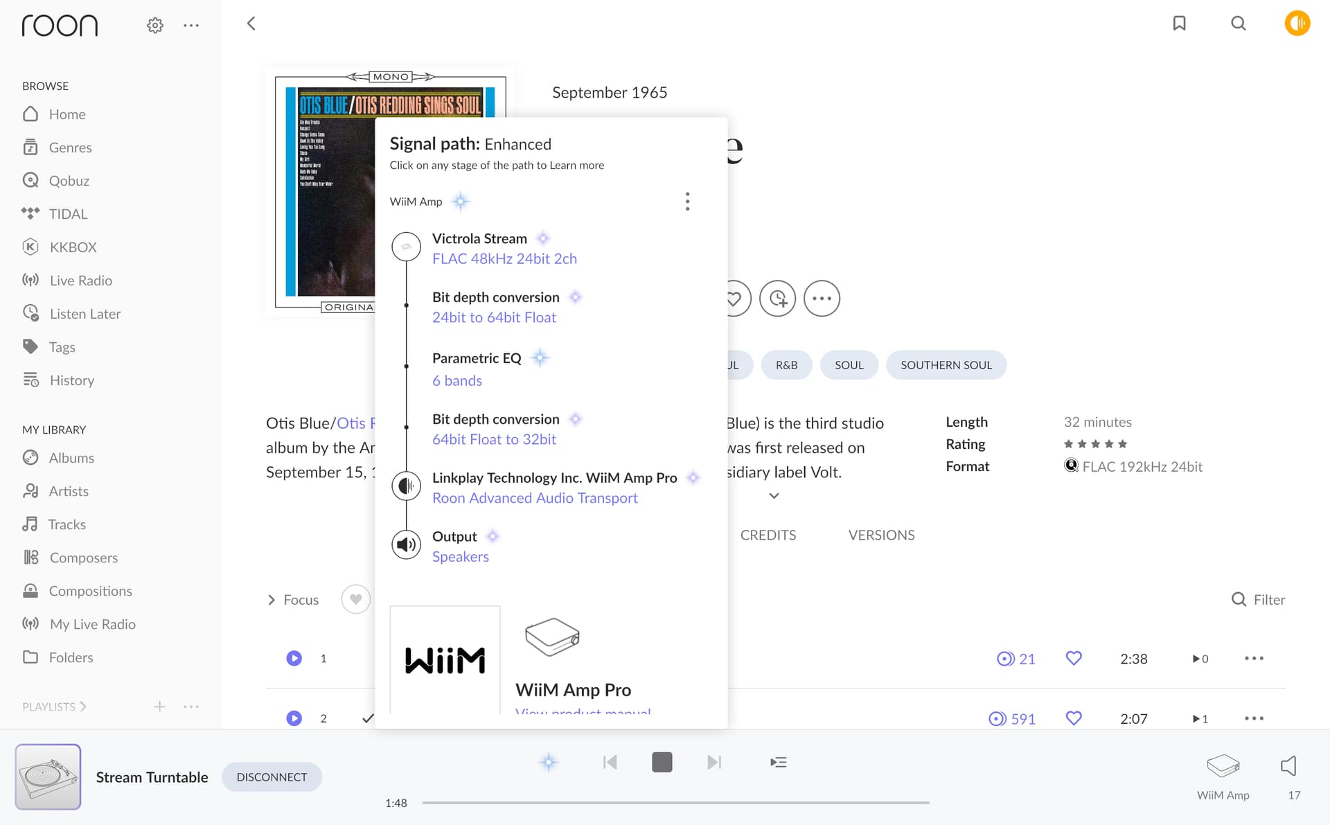

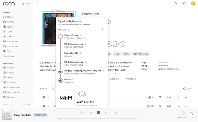

Can we see the signal path when streaming vinyl with Roon? - YES, you can on a tablet and laptop, but not when using Roon Remote on the phone, due to UI limitations.
Can we apply MUSE signal processing to vinyl streaming? - YES!!
