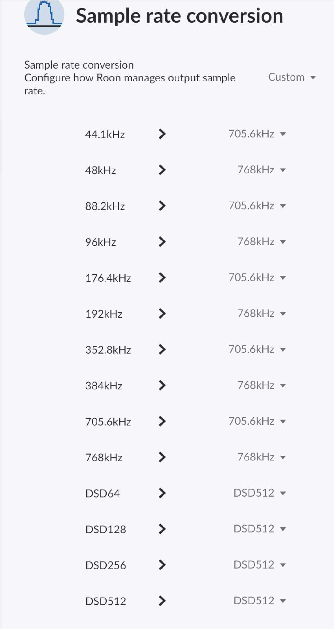

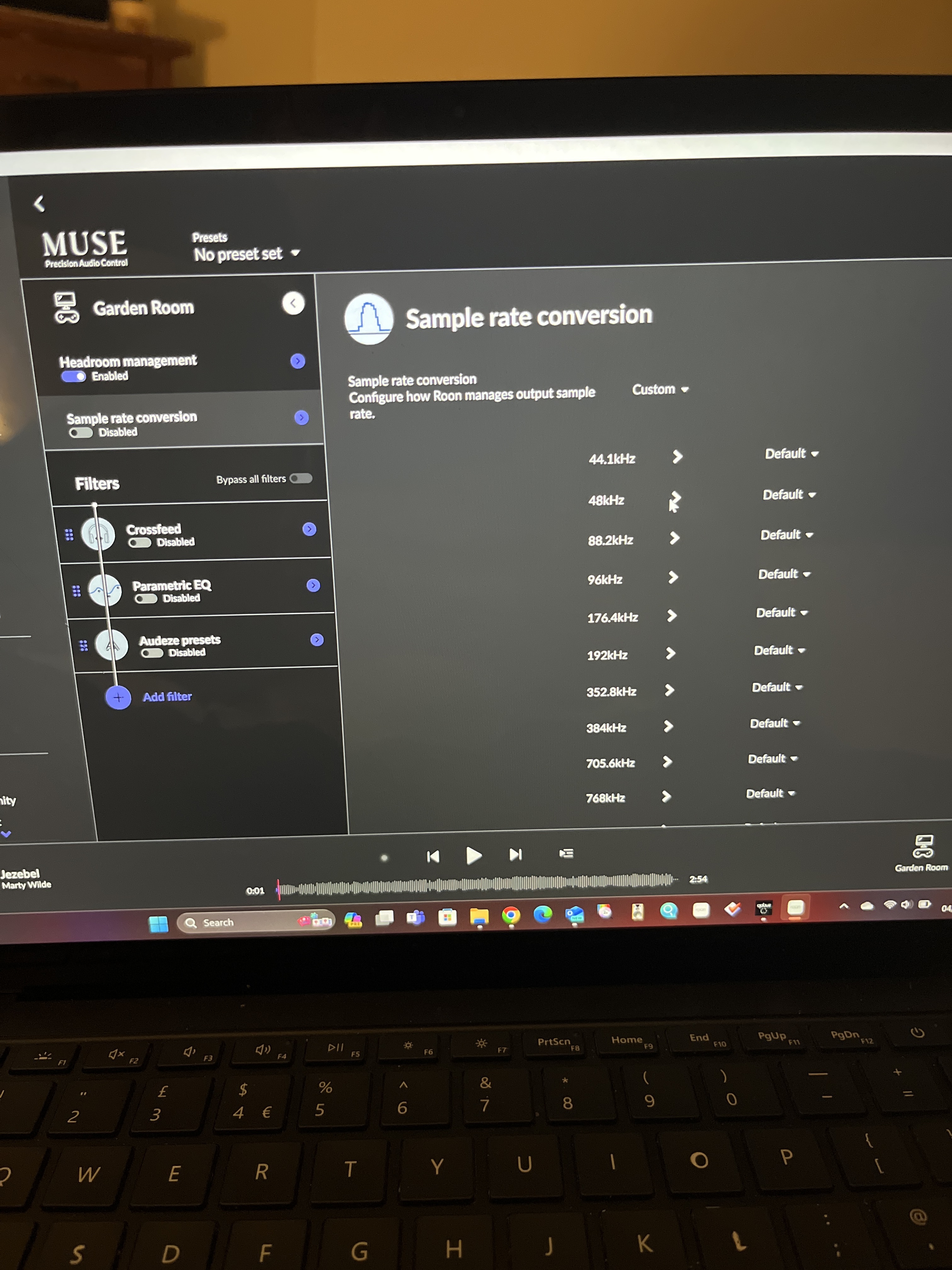

Just dusted off my DSD capable DAC. Initially, I found that everything was being converted to PCM, even when Native or DoP was selected in the dac device setup. Turns out that I had sampling rate conversion enabled on the DSP menu, intention to upsample PCM to max sample rate. My assumption that DSD would be excluded. Well, turned off sampling rate conversion and voila, both Native and DoP working beautifully
Is there a way to exclude DSD from sampling rate conversion? - or am I doing things wrong?
