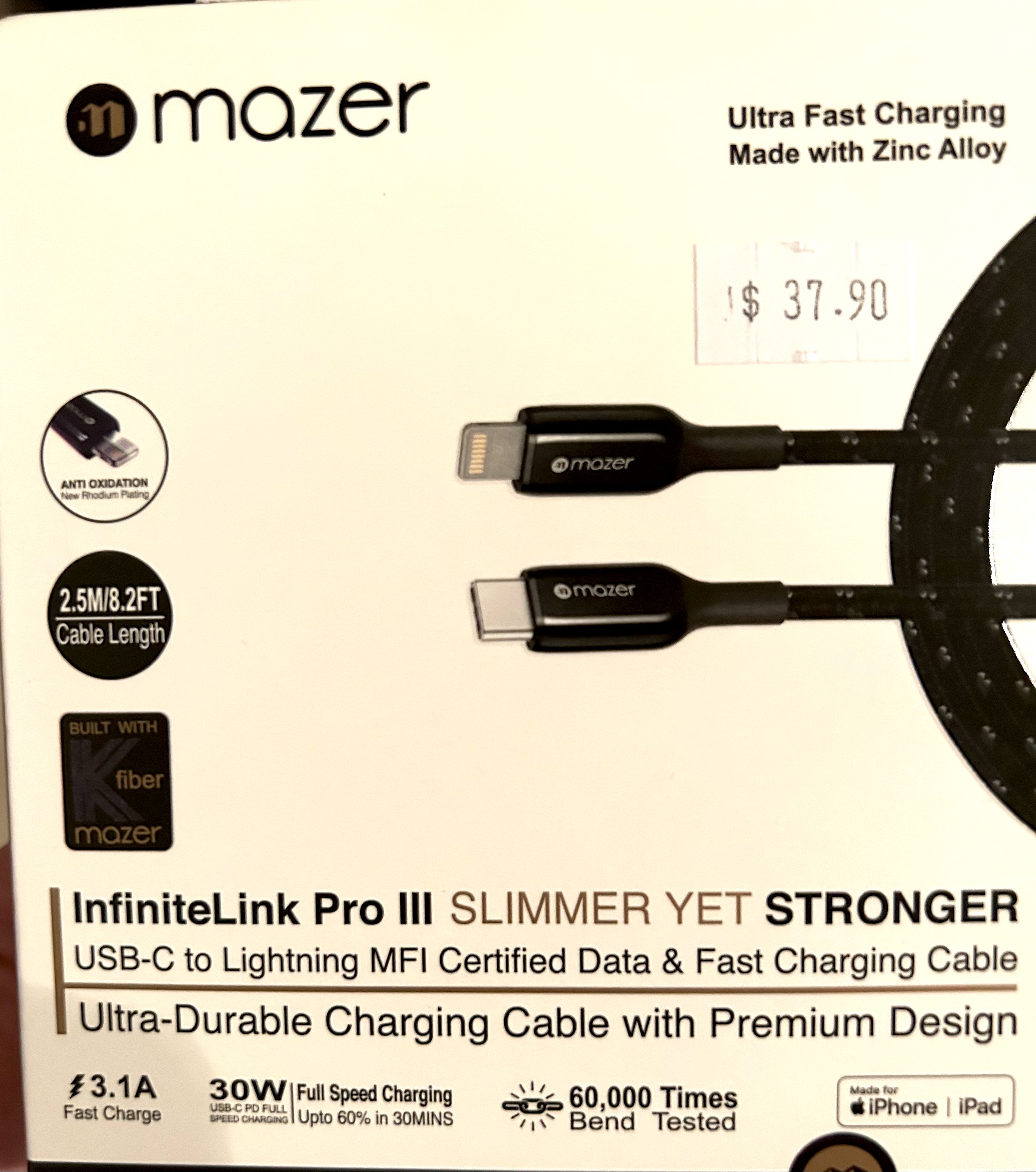

Thanks but that‘s what I already tested after Fiio‘s suggestion:
Hm I dunno then. Complain to Mazer? :slight_smile: Or try one from Apple, the Mazer does not seem cheaper as far as I can find online
