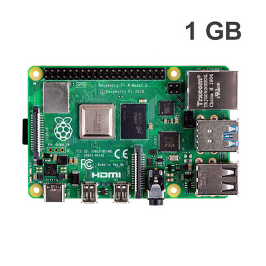

Newsflash: The $35 Raspberry Pi 4 is back (at least for the moment)!
This 1 GB model is perfect for running Roon Bridge.
