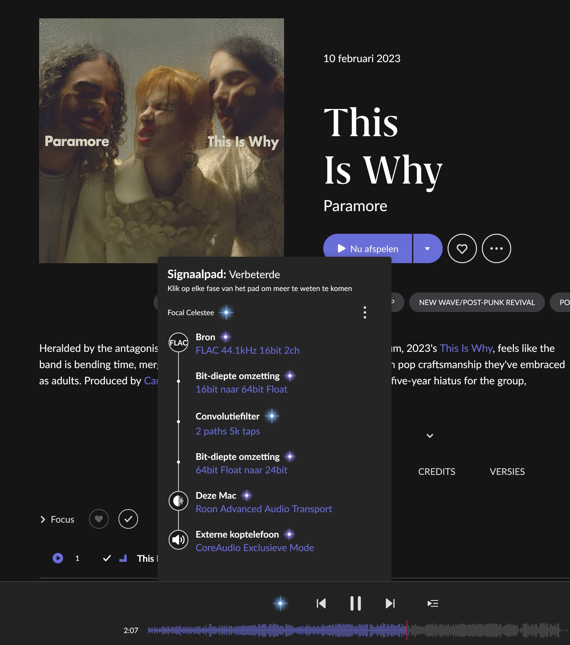

That looks good, but I’d recommend to zip together the two sample rate family convolution .wav files and load them in Roon, instead.
Give it a try, set up DSP presets for both methods to compare on the fly, with just a short pause when switching, to see if you prefer one method.

Ok, thank you.
The manual configuration sounds better. By a lot. What could be the reason?

The Celestee sounds great without DSP.
Configuring DSP manually with oratory1990’ settings as described in my first post makes it sound fantastic instead of great.
Then I gave the two zipped WAV files a try. Not bad sounding but not as great as the manual configuration.
I prefer the manual configuration as it has the most depth and clear sounding image. I hope that describes it best.
It’s the same settings though so makes no sense. When using the wavs you don’t need any headroom as it’s already been applied.
Oops… that explains! I needed to disable the preamp…
Rookie mistake!

As I suspected, it’s been caused by …
Good, it’s fixed now, and happy listening, @ericafterdark …
… but you may want to polish your descriptive skills regarding auditory impressions, the difference mainly being different loudness.
