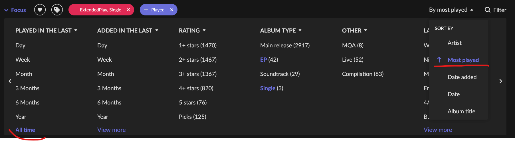

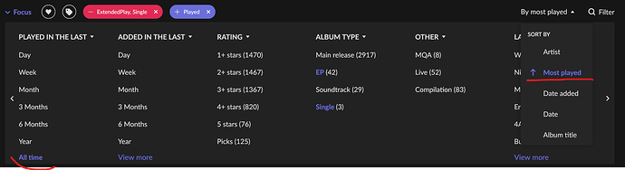

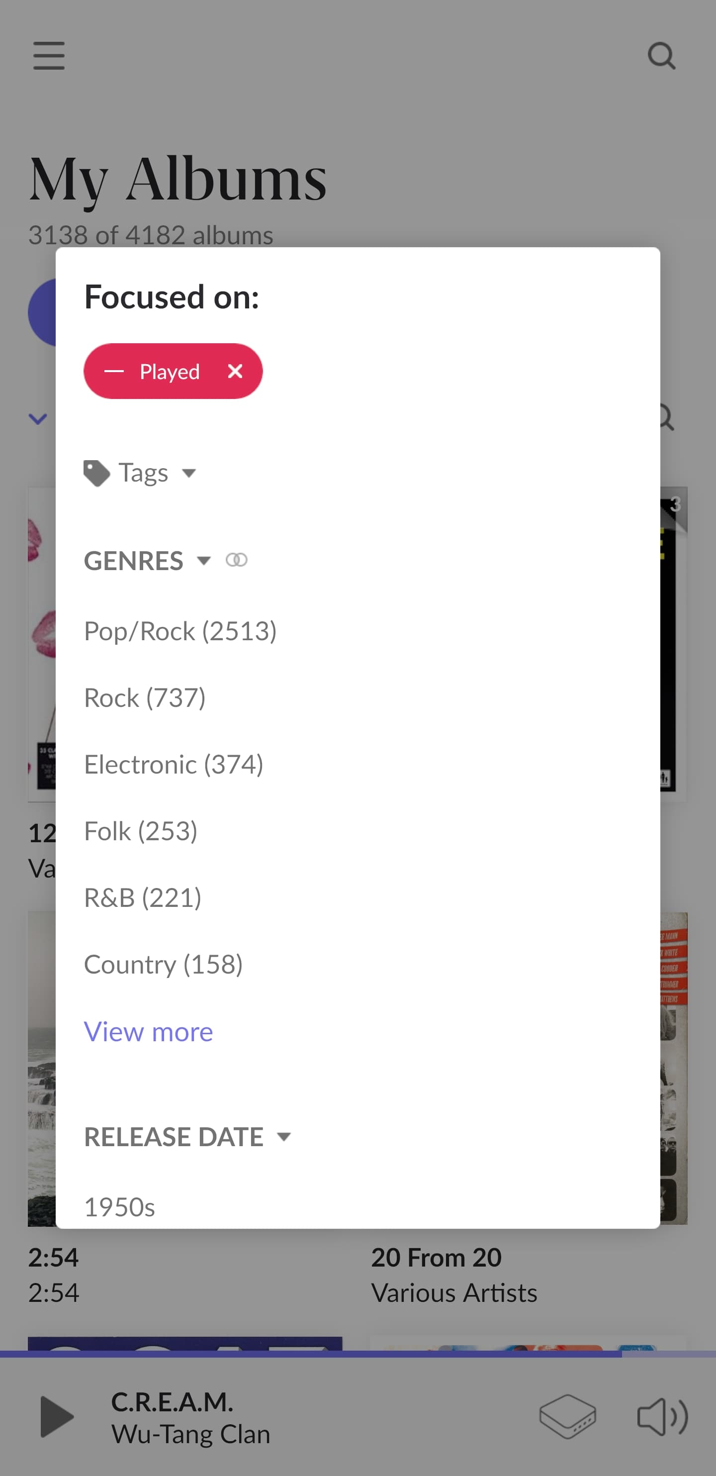

Select played in focus then click on the focus tag to reverse it, so you get unplayed. It goes from blue to red.
Here’s my workaround : I have created a ‘Least Played’ bookmark (albums that have been played in the past but sorted in ascending order) Any album that has only been partially played will appear at the top of this list, so I can find them back easily.

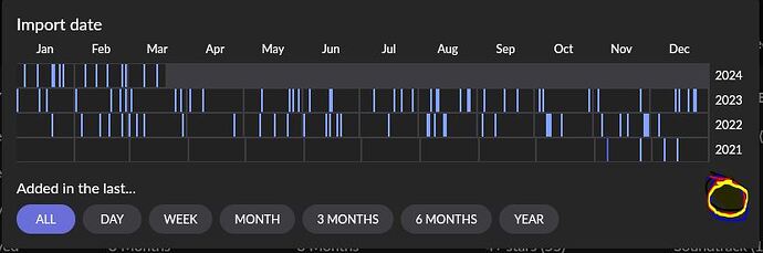

Also, there are still some (long standing) bugs in focus that should be addressed. The rolling 3 year limit for “Added in the last - All” being top o’ the list. The previous Focus handled this much better.
