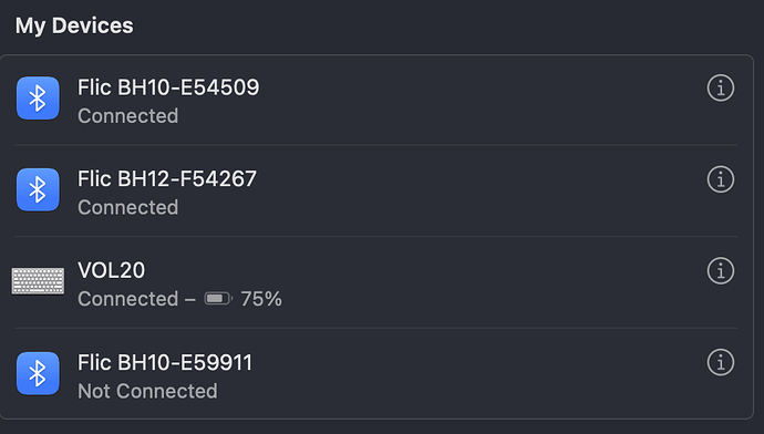

Well… That escalated quickly – Amazon just dropped off the VOL20 this morning.
Impressions so far: it does feel heavy and well made. The top half has a bit of play, causing the wobbliness seen in the video. In practice however you don’t experience this as such – it all feels solid with some heft. The spindle bearing is a bit coarse, but with well defined notches allowing for fine-grained volume control.
The VOL20 pairs with anything and identifies as keyboard:
This means that all knob commands (vol up, vol down, play/pause, next, previous, mute) are sent as keyboard commands, making this the easiest knob I have ever worked with. :wink: I don’t have a good feel for the Bluetooth reconnect speed from sleep as of yet, but all looks fine so far.
My current setup is a Mac mini M4 hidden in the TV cabinet. I capture the keyboard commands with BetterTouchTool and map them to a variety of options:
  • A set of Python scripts controlling my KEF LS60 directly via pykefcontrol;
  • A set of shell scripts controlling Roon via rooncommandline (my speakers being RoonReady means that volume commands are valid for any source);
  • A set of Applescripts manipulating the Spotify client running on the mini directly;
  • A set of keyboard shortcuts sent to the Roon app running the background;
  • Having the volume commands captured by Volume Control, a nifty little app that maps the volume keys to Spotify or Apple Music, instead of the system volume.
These all work just fine. Almost boring actually… You may just want to order one, @DrCWO. :wink:

Out of the box, it works on system level – the dial and button functions of the VOL20 do exactly what your media and volume keys do. When Roon is the active player, play/pause, next en previous work. Volume only works when your volume keys work as well (for Roon this is only valid when using System Output – otherwise the system volume is controlled).
You can to remap the volume/mute keys to Roon commands. I do this with BetterTouchTool: on a desktop vol up would be mapped to CMD-Up-arrow and sent to the Roon app specifically.
