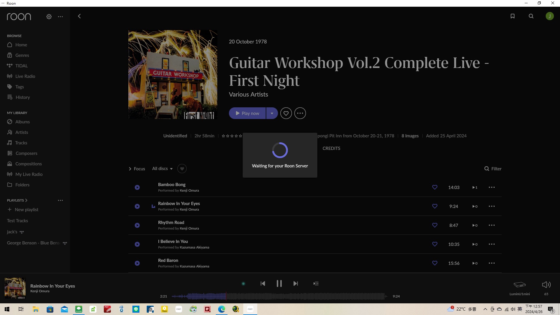

I install rock on Gigabyte Brixi7 this week. The problem now is very often happened "waiting for roon server" and recovery within 30 seconds. and then it come again and again...
I use TPlink C7 router which connect rock server on Brixi7. remote by NUC wifi to router.
Do not use W-Fi with Roon Server / ROCK. Moreover, the Gigabyte Brixi7 isn’t a supported platform for ROCK, so this falls under Tinkering.
You may fare better installing Linux and running Roon Server on this.
Thanks for reply.
The remote Roon use wifi to router but Rock server is line connected to Router. It’s no problem at all before when i use roon core on NAS or another pc installed rock server.
Anyway, i’ll try line connect and see the results.
