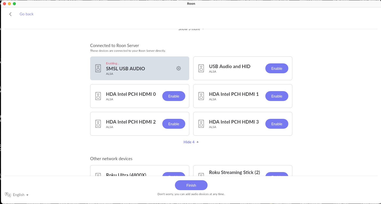

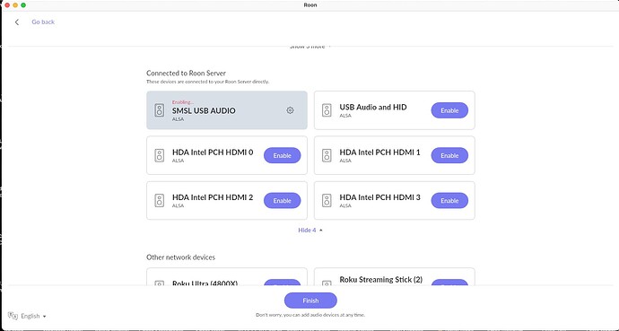

Thanks, Frank. Very helpful. I suppose the following is somewhat irrelevant since it’s advisable to get a Bridge, but I noticed (after stopping Rock, deleting the RoonServer folder in its Data directory, restarting Rock, and running the Roon app on my Mac) that the SMSL DAC is detected - as shown in the screen capture below. But, when I try to enable it, the SMSL DAC entry disappears (as do the other entries that follow that entry). [hmm, not sure whether I’m adding the screenshot correctly]
Hi Kevin,
That is exactly the same comportment I had. The Roon Core tries to connect, but is not able to, so it removes the DAC from the list.
Kind regards, Frank.
