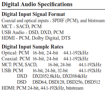

I guess this information isn’t in the manual?
Not really, indirectly at best if you want to be generous. The network as audio input does not get mentioned in the manual’s specification section at all.
From this, only USB is specified for higher sample rates and DSD support. SACD for MCT means SACD player (encoded with Sony copy protection cypher) only.
Note: The network isn’t a straight audio input. It is sort of a meta input, supporting various (transport) protocols that may have each their own limitation. Examples: AirPlay (44.1 kHz, 16-bit), ChromeCast (48 kHz without and 96 kHz with hi-res flag set, 24-bit), …

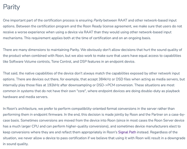

Interesting quote regarding “parity”…
So, parity is limited to network connections here. The rest is rather ambiguous.
Hhmmm… so, following this “definition”, their shall be no roon Ready device that accepts multichannel audio through a network connection like e.g. DLNA/UPnP but doesn’t via RAAT?
Might be true.
