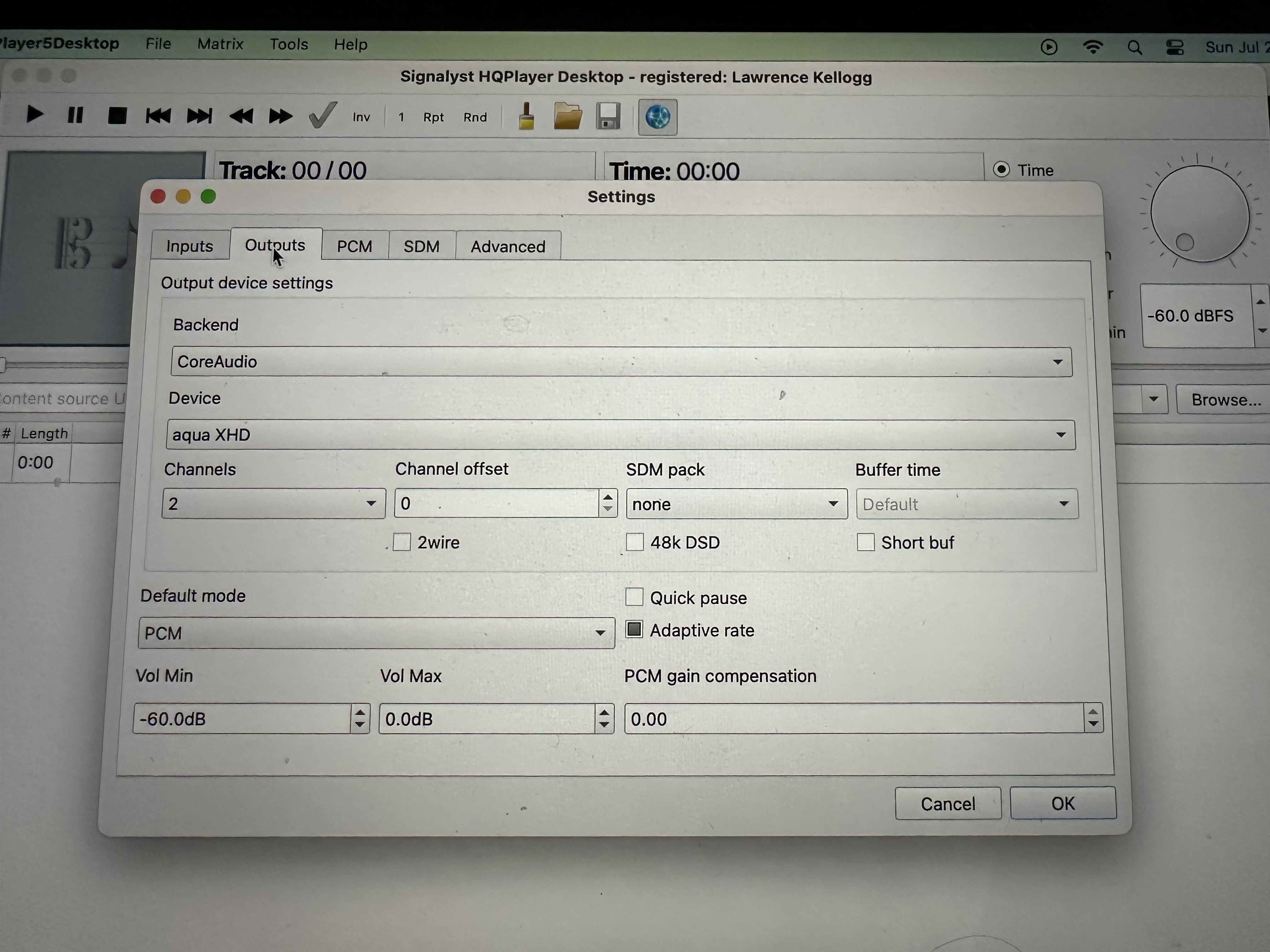

I picked CoreAudio as the output device for HQPlayer.
Now, I seem to have a connection from HQPlayer to the Aqua Formula but no music.

Please try to get playback working with standalone HQPlayer first. Then you know output is working. You can then add Roon to the picture. So working from output towards source step by step.
Screenshot of your HQPlayer settings would also help.

Standalone playback through the intended output path, meaning your Aqua Formula. I recommend to also make sure that the DAC used for HQPlayer is not set as macOS default audio device. This way, macOS won’t try to play all kinds of notification sounds and similar that would intervene with HQPlayer output.
Ok, but the output from HQPlayer should be CoreAudio, right? That is what is supported by the Aqua Formula.
Your advice leads me back to debugging with the Aqua Formula in the loop, which is fine, I guess, although I thought you were leading me away from doing that.
I have the default output device set as the Mac Mini speaker.
I have both running, and I have set the output to CoreAudio and aqua XHD device but I keep getting that Roon has lost control of the Audio Device.

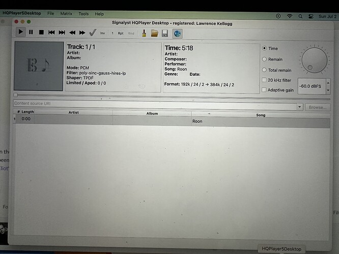

I seem to have gotten Roon to stop losing the audio device, and when I stream from Roon with HQPlayer, the time moves, and the Formula shows a sample rate of 384 but no music comes out…:
I can change the sample rate of the output on the Formula and it changes the light, from 384 to 192 and back but still no sound is produced.
I suppose I could change filters or something but I am really at a loss as to why it does not produce any sound.
I got sound but it is low!
What is the volume set to -60 when I set it to Fixed? Am I missing a setting to Fixed on this screen?
I have to crank it up a lot to get a decent level.
Do I have to set it to 0.0dBFS to get Fixed? It seems that way. That’s confusing.
Never raise the volume level of HQP higher than -3dB. -60dB is the default setting to avoid people breaking their ears and speakers.
Where did you set it to fixed?
As @patouskii said, the volume shouldn’t be set any higher than -3 dBFS. Otherwise you will start triggering limiter due to inter-sample overs.
I set it to Fixed in Roon but that doesn’t carry over to HQPlayer, it seems.
Maybe it needs a little fixed button or something to prevent people from setting it higher than -3dBFS. I changed it.

In my own defense, I started my preamp at -69 so combined with the -60, it was inaudible. I didn’t think that volume control was active.
I understand preventing people from blowing out their speakers. I would never start anywhere except at -69 on my preamp.
Yes, HQPlayer and Roon settings are independent of each other and not related.
If you leave Roon set to “Device volume”, Roon will adjust HQPlayer’s volume. From Roon’s perspective, HQPlayer is the “output device”.
Sometimes people use DAC direct to power amp, without preamp. In such cases it is pretty important to limit initial volume! For this reason, HQPlayer also allows one to set the volume control range, both minimum and maximum values, to reduce likelihood for accidents.
