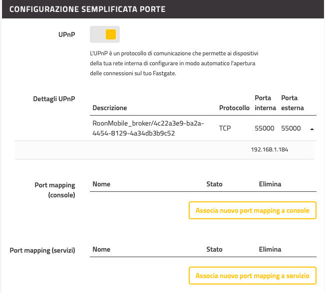

in the internal network I have set a fixed ip for the mac where Roon resides and ARC does not activate
also place the configuration of the modem router where you see the port 55000 and under the IP of the mac where there is roon

Right, but the fact that you have two modems leads you to this “Multiple NAT” error.
Roon gives in their manual some possible solutions (bridging the modems is one of them, but not always easy and not always possible).
Another solution is to do some port forwarding in both modems:
First, you need a P.F. from the external ISP address (93.48.253.185) to the internal IP address of you ISP modem (10.154.158.103). Then, in your second modem, you also need a P.F. from that last address to your Roon Core (192.168.1.184).
This could help solve the double NAT issue.

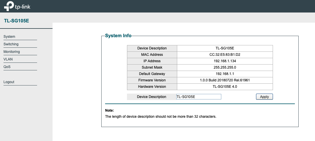

here the switch settings
am I wrong something?

93.48.253.185 = public IP
10.154.158.103 = could be private address assigned for CGNAT
192.168.1.184 = private address of the roon core
That could be CGNAT, ISPs don’t always use the correct address range for them

and this is the tp-link switch i use for pc, for Roon and for audio playback software (2 machines)

From what I can tell from my research, you definitely need a public IP. As @ChrisRoon mentioned, please look at the article in his post.
This is what I found when I looked up your modem:
This is from the article below:
" Get a public IP
The Fastweb network is very different from that provided by the other operators: normally all users are connected to a network with shared IPs, so it is not possible to open a specific door and be reachable from the outside, since we are present inside an untangled and complex network (remote services would not know which modem to point to).
To be able to proceed with the correct forwarding of the ports, we will have to request assistance, requesting to obtain a public IP of Fastweb (ie an address assigned only to us and accessible from the outside as already explained in another post).
The easiest way to get this IP is to call the phone number 192193 (from Fastweb fixed line or from Fastweb SIM), follow the commands of the voice guide and talk to an operator, so as to be able to advance the request."
