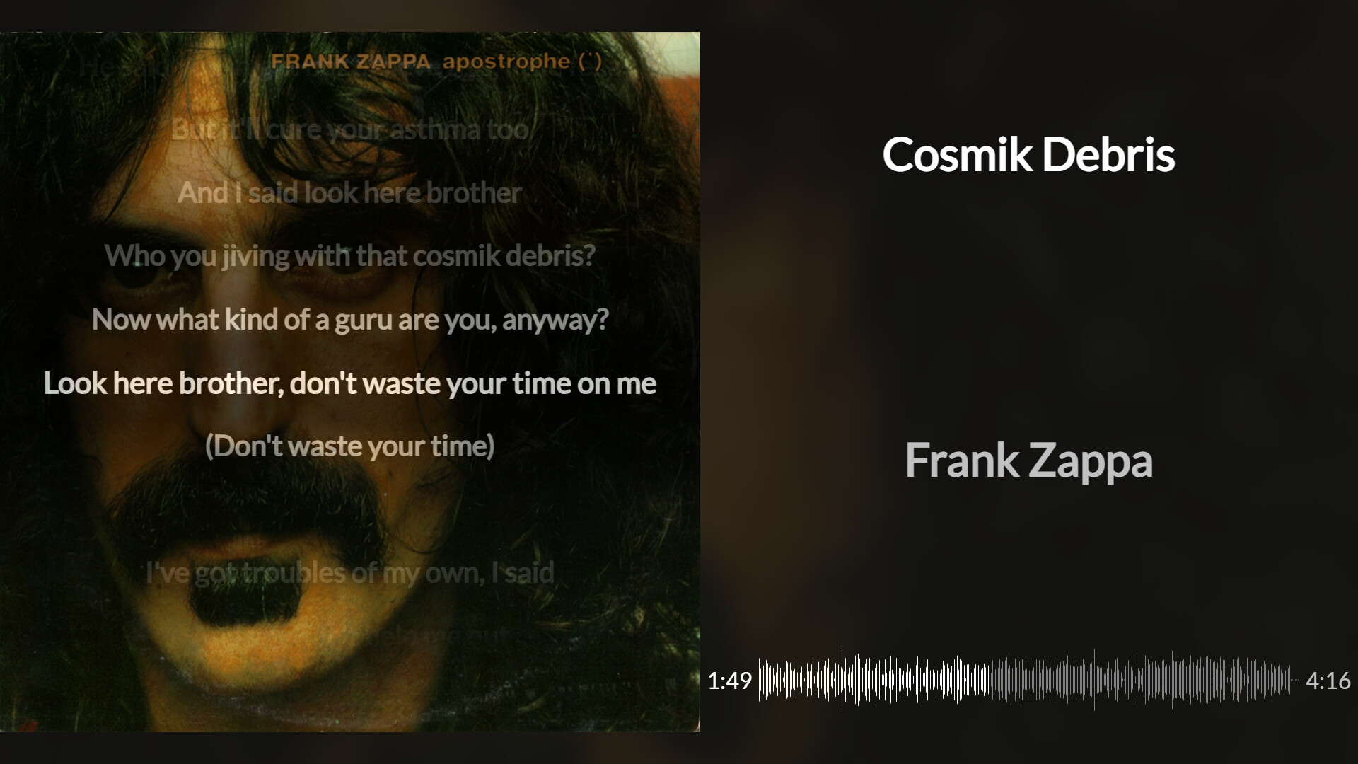

Anything other than ROCK will give you the opportunity to attach a budget HDMI display and use it as web display - and you could customize what and how that display shows, like so

@Marin_Weigel makes a good point about using a monitor connected via HDMI. Some monitors in the category you’d be looking at are powered via standard 5v USB which would allow you to connect directly to one of the USB heads on your board. The other option is 12v DC which you could probably pretty easily source from your power supply. Either way, I think this is probably a better option than a Pi jammed in the case.
Unfortunately, Roon has just one set of html/javascript files that drive not just the connected display but also any additional displays or Chromecast devices on your network. I’ve played with these files, similar to what @Marin_Weigel has done, and I’ve found it tricky to find a single strategy that works well for me. All that said, as much as I like the idea of a “Now Playing” screen, I’m not sure I’d be happy with it in my server case.
