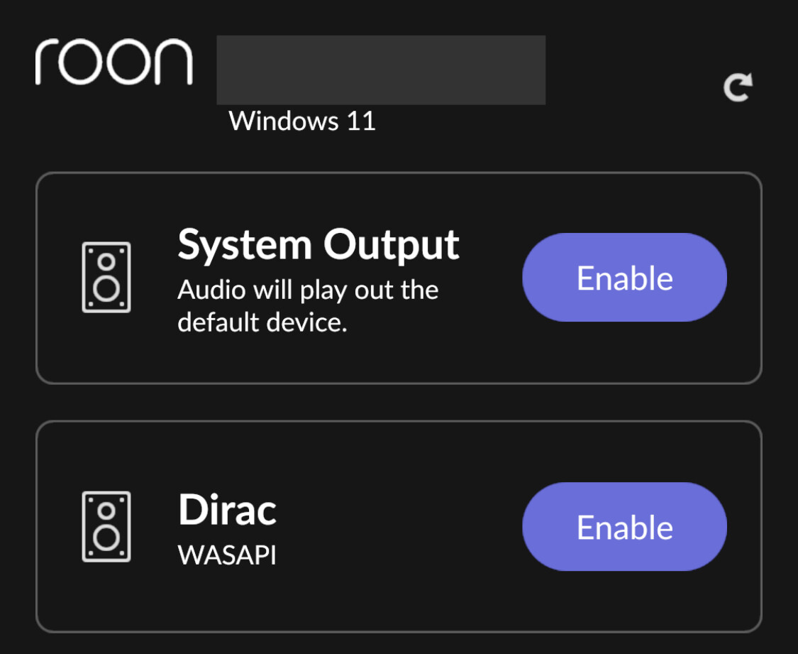

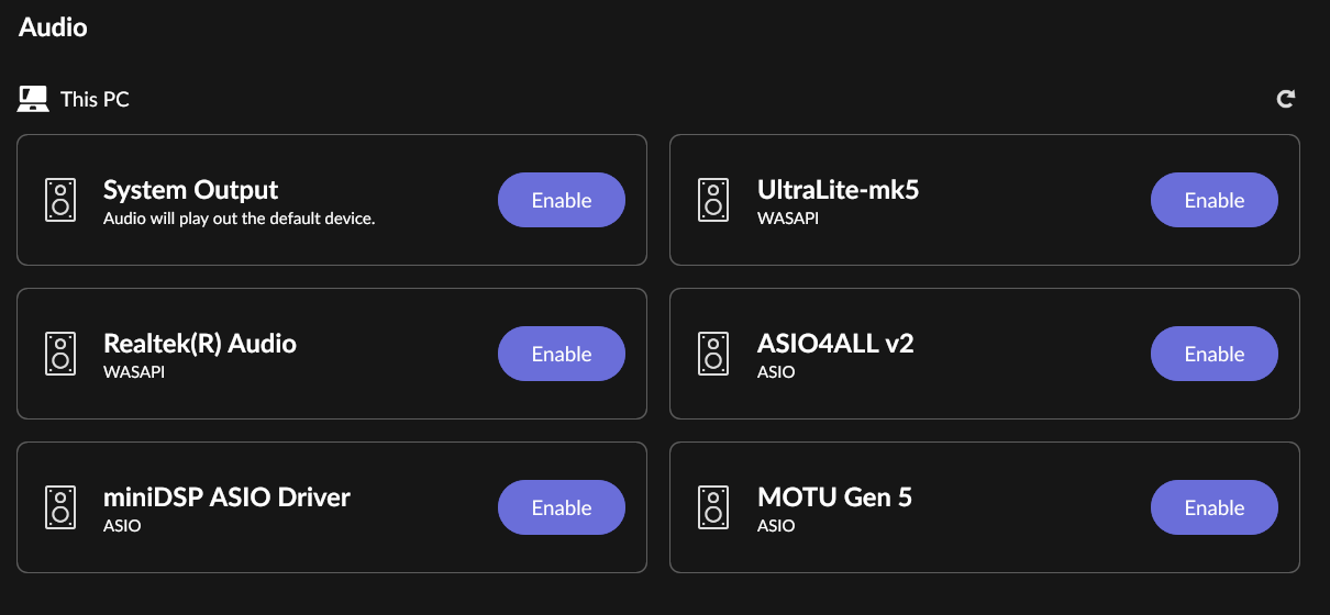

If your laptop with both roon bridge and Dirac install and correctly connect to the same subnet as your server. Audio device will show like following pictures in your remote.
Without Dirac installed and DAC connected, at least “System Output” should be there.
