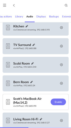

I’ve went in to Settings>Audio on the Roon app, how do you tell the Roon server to connect either via Airplay or Chromecast?
I think you would need to enable that mode on the device itself or Roon bridge device, then you would see it as a choice to connect to in Roon - Settings - Audio.

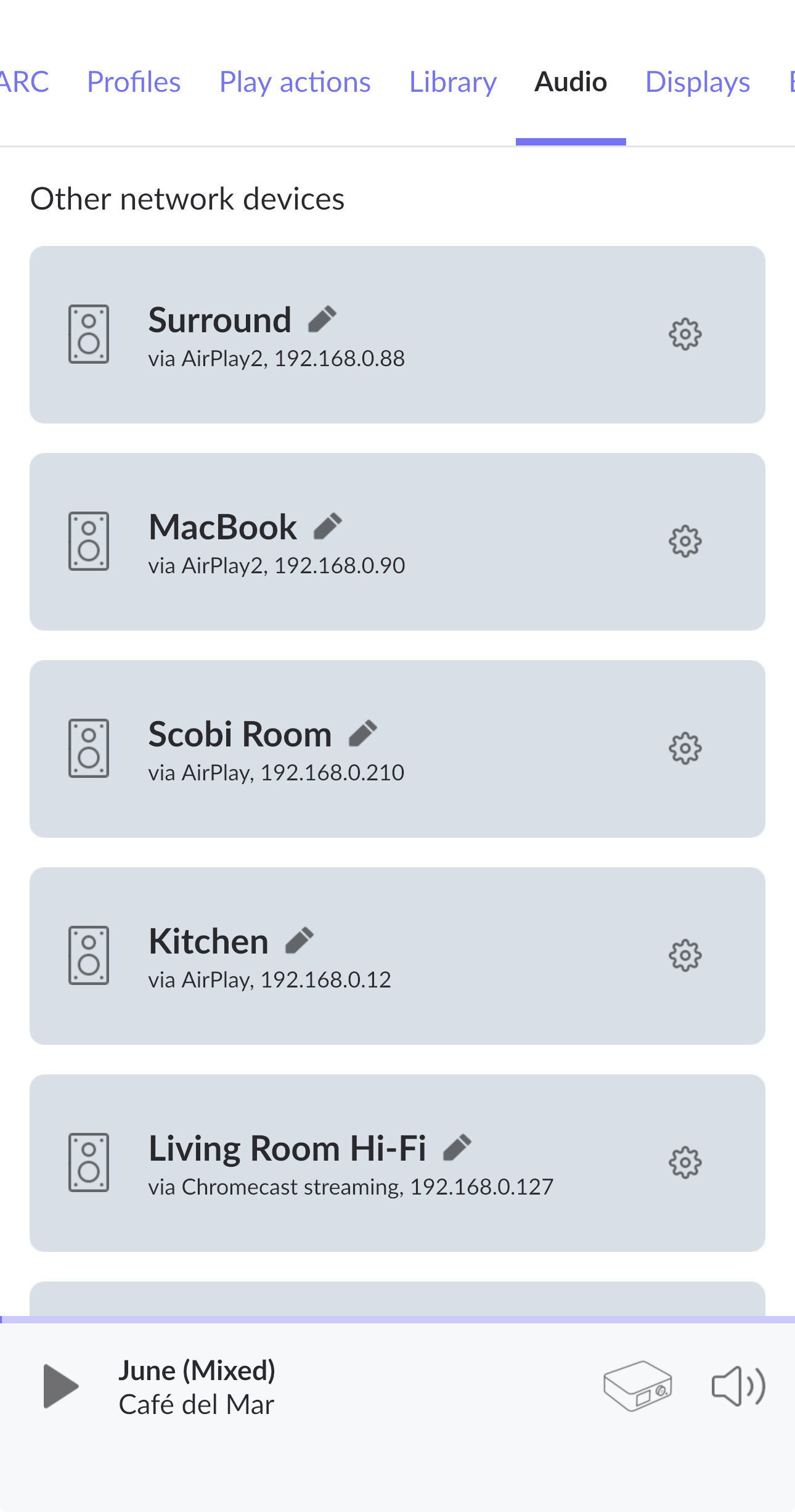

As said, go to Settings > Audio. Then scroll down to the section “Other network devices”. There you should find ann AirPlay instance of your WiiM Ultra. Click the “Enable” button next to that instance. This will create a new zone for the WiiM Ultra in AirPlay mode.
Note that you will now have 2 separate zones for the WiiM Ultra. One using Roon’s RAAT, another using AirPlay. The AirPlay zone can be used for grouping with other AirPlay devices.
If the WiiM Ultra is anything like the WiiM Pro or WiiM Amp, you also have the ability to use Chromecast, but this needs to be enabled through the WiiM app. After doing so, you will have yet another instance of the WiiM Ultra in the “Other network devices” section that you can choose to enable.
The WiiM Ultra isn’t Airplay enabled, it’s chromecast.
The other speakers are chromecast compatible but are shown in ‘other network devices’ as Airplay.
The WiiM Ultra is ‘Living Room HiFi’
If you scroll further down the list of “Other network devices”, do you find any Chromecast instances of the Audio Pro speakers? If so, enable those (and optionally disable their AirPlay) instance. You should then be able to group the WiiM Ultra Chromecast instance with the Chromecast instance of the speakers.

Can’t see any instances of the Audio Pro in Chromecast which is strange.
I’d have thought I could group all the speakers through Chromecast.
Which model speakers do you have?
Audio Pro C5A, I’ve just done some digging and it appears they’re only AirPlay.
The C5MKII is Google Cast enabled so I’m going to replace the C5A in my kitchen with the MKII and at least that way I can group the living room and kitchen speakers.

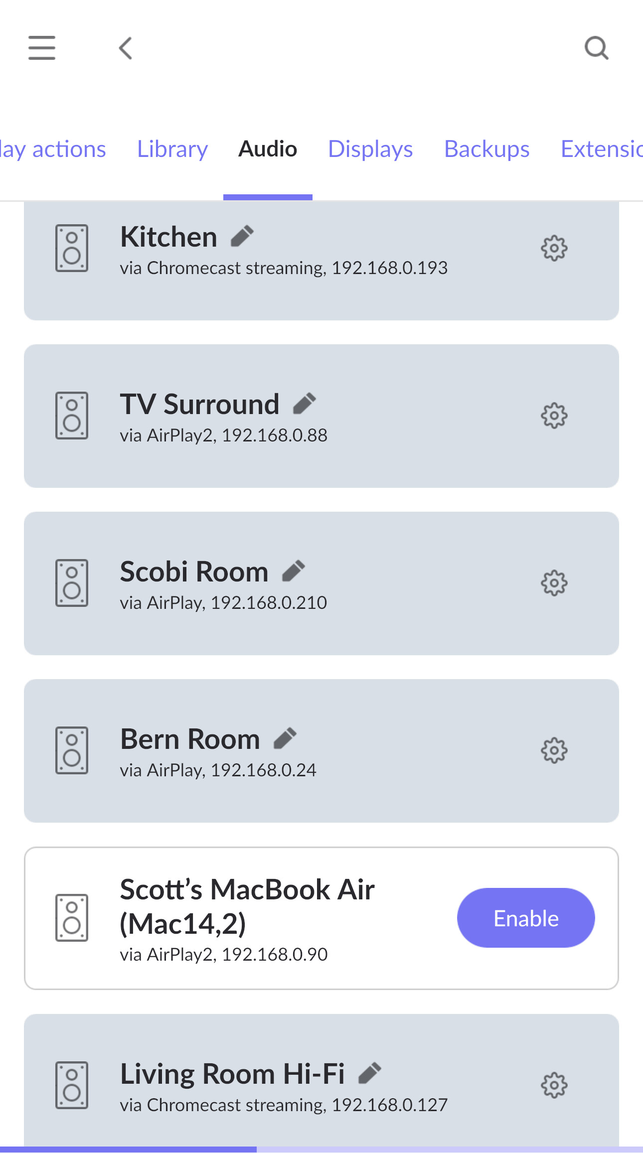

I’ve just bought the Audio Pro C5II which has chromecast enabled and it still won’t pair with my WiiM Ultra that is Chromecast enabled.
Anyone know why they won’t group together?
It’s Living Room Hi-Fi and Kitchen I’m trying to group.
