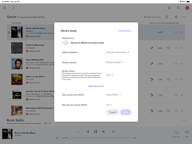

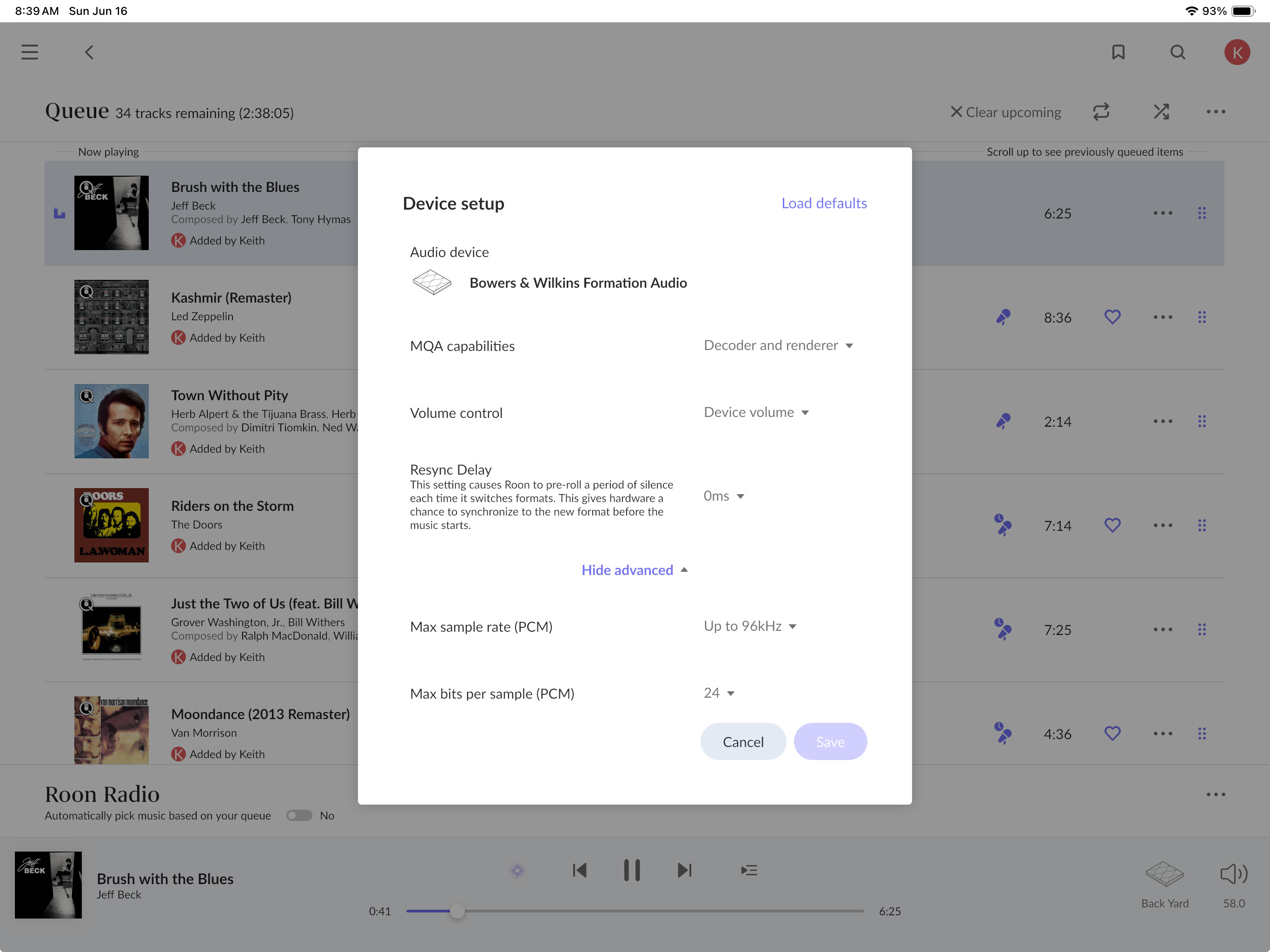

What are the settings under the audio device?

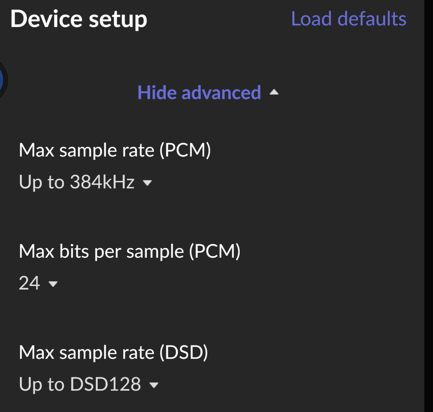

Under Advanced settings, here are mine for my Mini-i Pro 3 I am currently listening too

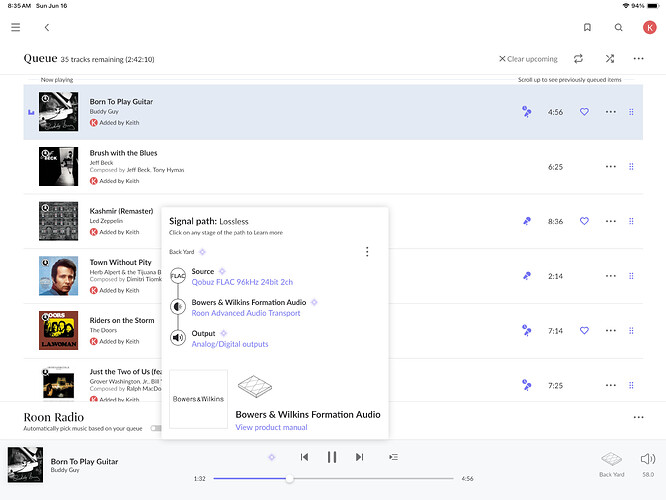

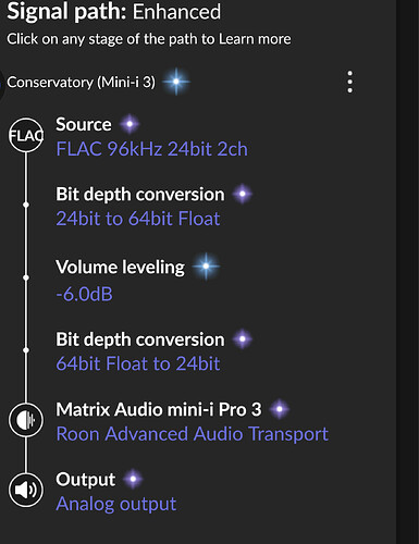

Can you also send a screenshot of your signal path, like this
Attached Michael.
Thanx,
Keith according to this screenshot you are getting 24/96 output and not 16/44.

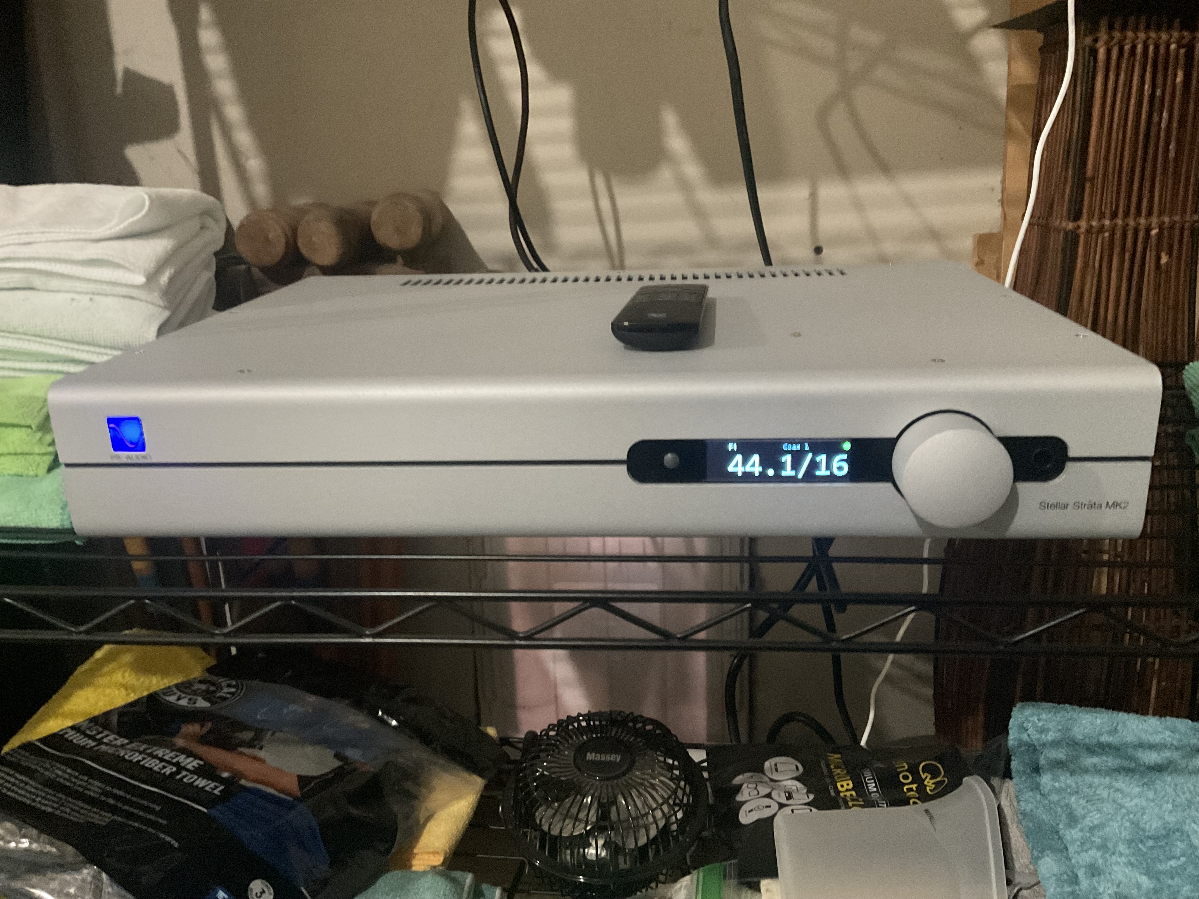

Display on both DACS say 44.1/16

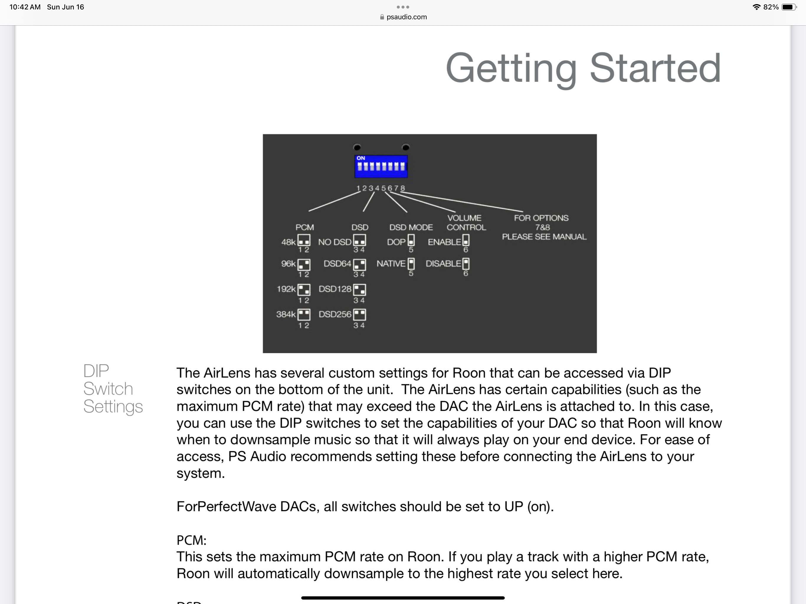

There are no setting on the Airlens just dip switches on the bottom and they are all on, default, all on.
