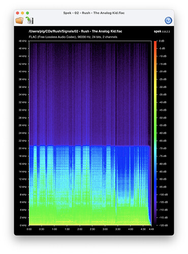

seems like a bad sign? (used Spek on my mac on one of the FLACs that is supposedly 192 KHz)

As you say - assuming the tool is working correctly - that isn’t good - clear signs of a brick wall filter at 20k!

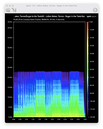

Questionable: Julien Baker/Torres sold to me as 96 KHz ; looks like a brick wall at the nyquist for 44.1 KHz

You are doing all the right things and getting the right answers using Spek. Sometimes you aren’t getting what you pay for, and Spek is a great way to fight back and keep vendors on their toes. I’ve used it to get refunds in the past.
