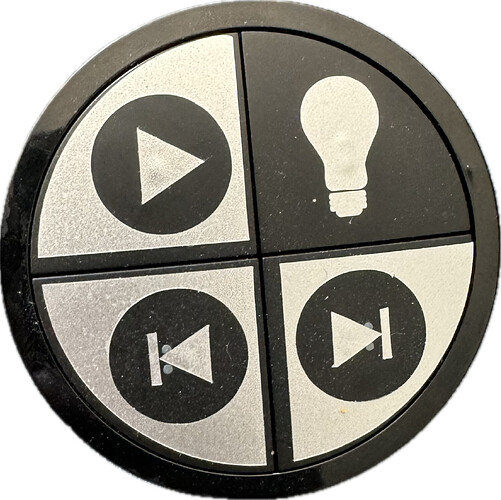

My only other thought is that intuitively from the button position on the device I expected 2/4 to be next and previous track. I need to label the buttons anyway!

This was just a choice on my part. I found that it made the most sense for me, personally, to have the previous and next track buttons be in left/right position versus something else. So I label my buttons like this:
Unfortunately, this labeling approach I use is complicated and error prone. I can’t easily share them. But this will at least clarify why I did it this way. I use the upper right for controlling the lights in the same room as the endpoint.
If you prefer the north/south orientation for transport (or any other changes) the other blueprint might be a better choice. You would just have to create the automations for the buttons and volume adjustments (small, medium, large in each direction) but that’s pretty straightforward. Once you have that set up for one control, you can just duplicate the whole thing for other rooms.
