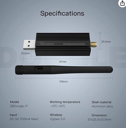

The Sonoff ZBDongle-P is very popular and is plug and play with, for example, Home Assistant running on a Raspberry Pi.
There are similar Sonoff dongle’s with different model names. You’ll want to make sure you are specifically getting the ZBDongle-P.
In the US Amazon listing (for example) you’ll see this image in which the correct model is identified:
At Amazon US, it’s this: https://a.co/d/1tawgw5
Great. Many thanks. I am in Europe but believe found the right version on amazon here.
