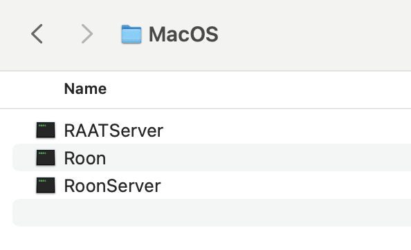

Some long-term experience with macOS led me to right click on the Roon application bundle in the Finder to “Show Package Contents” to see what executable components are part of that application bundle (fact: Applications in macOS are just fancy folders; you can right-click on them and use that command to see their contents):
In there, open Contents > MacOS, and you will see three files:
These are the actual core executables that constitute the various parts of the Roon application.
Thing is, neither “Roon” nor “RoonServer” are explicitly in the firewall list. Ostensibly, they are in there implicitly as part of the “Roon.app” application bundle, but not explicitly.
