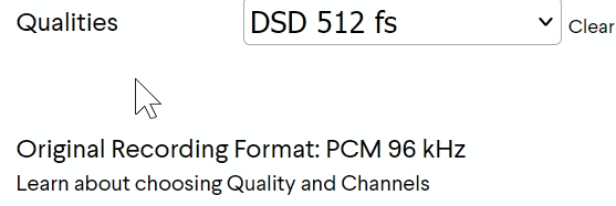

I am saying that at least I can understand buying the original recording resolution (which could be 16/44.1 or could be DXD; could even be some straight DSD). Paying more for upconversion seems silly, DAC will do it anyway, and if one is insane enough, you could get Roon, HQPlayer, or any number of other things to do it.

I didn’t know red book quality was being upsampled to DSD & sold at a premium, that’s straight up fraud IMO, like watering down beer or selling anything by volume & giving less that the customer paid for.
