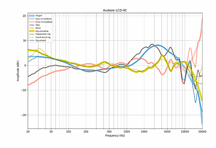

When this is the Parametric EQ settings
And the EQ is the yellow line in the middle
Wouild just check the bands again for the XC
This is the measurement chart for the LCD-X
So the curve in ARC MUSE does look like the yellow EQ curve.
Just check the top band setting.again.
