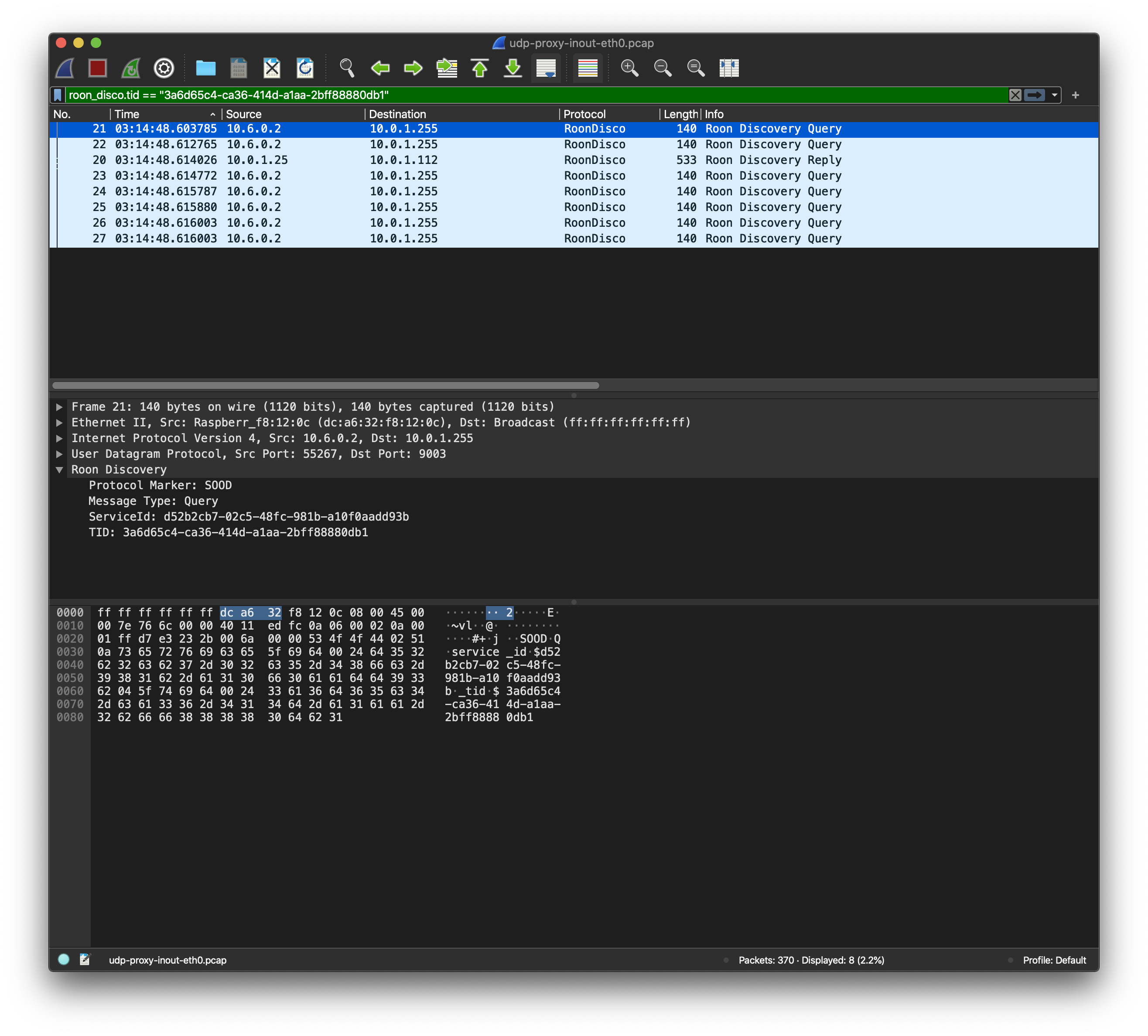

I had the opportunity to ask Roon during last weeks “home network webinar” if they were willing to share the technical details for their network discovery protocol. Sadly, I was informed that Roon has a policy to not share any details of their network protocols. :frowning:
The good news though, is that the protocol is not actually that complicated. And thanks to others in the Roon community who shared pcap files I was able to write a rather simple “protocol dissector” for Wireshark. What is that? It’s basically a secret decoder ring which translates network traffic into something that is easy for humans to understand. As someone who believes in open source software, I’ve shared my code with the Wireshark community and I hope/expect them to accept it in a future release.
Example screen cap
In the mean time, I can say it has helped me diagnose a problem with Roon and udp-proxy-2020 with one person already. Hopefully that means we’ll have a solution for him soon, but time will tell. But progress never the less. :slight_smile:
Anyways, if anyone is still having issues please reach out on github and open a ticket. I’ll need some “pcap files” which udp-proxy-2020 will generate for you. And that + the new Wireshark protocol dissector can probably help pinpoint the problem you’re having.
