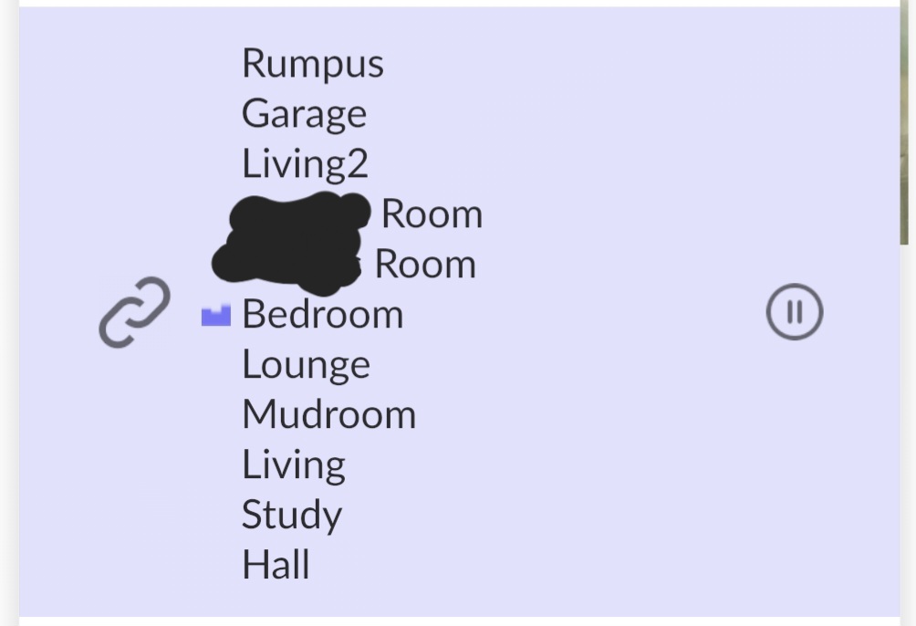

The family was away this weekend and I had a day straight of streaming to 11 zones (including the 2 shared Pis) while I pottered about the house doing stuff :rofl:
Side note, I now need to reboot the bedroom pi because I can’t switch the display back to the correct zone (after it auto-swiched when I grouped it with others).
