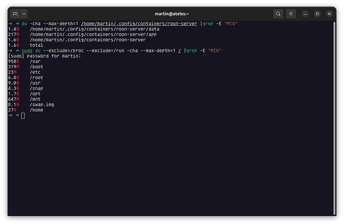

That’s because the path is incorrect. As an example, I based it on this image since I do not know the full path.
However, you’ve already shown ./volumeUSB1/usbshare/RoonOnNAS, so you need to locate the parent folder(s). It could be /mnt or /media. The webGUI should say where the volume is mounted.
However, if you run this, I can probably tell.
sudo du --exclude=/proc --exclude=/run -cha --max-depth=3 / |grep -E "M|G"

That’s all Roon is using. This seems a little low, but this all depends on the size of your database. The app used ~200 MB, and the logs ~15 MB. My database and data are 1.3 GB.
So, it would seem that the issue isn’t Roon.
If you append | sort -n to the last command it will show you the largest folders first.

Your library is comparable in size to mine, so it looks like something is wrong–you should have 1-2 GB for the DB. Even so, that isn’t much, and it’s not your / (root) drive anyway.
I don’t know how QNAP organizes the filesystem, but /volume1 is consuming the most space, and you have some pretty large folders.

The last two look suspicious, and may account for a duplicate 62 GB.
