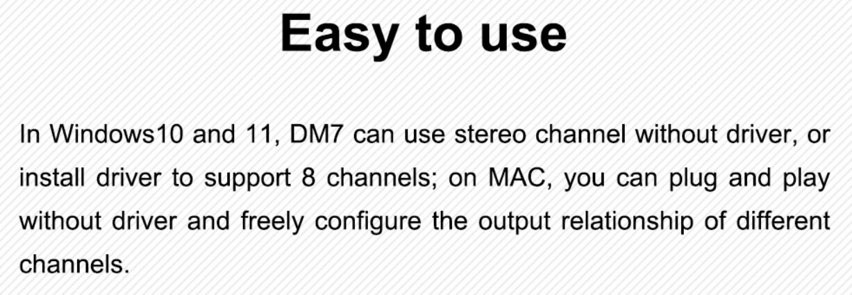

The DM7 seems to need a driver for multichannel…
My Motu works driverless (class compliant) in recent Linux versions. No issue.
From Topping website:
https://www.tpdz.net/productinfo/862560.html
