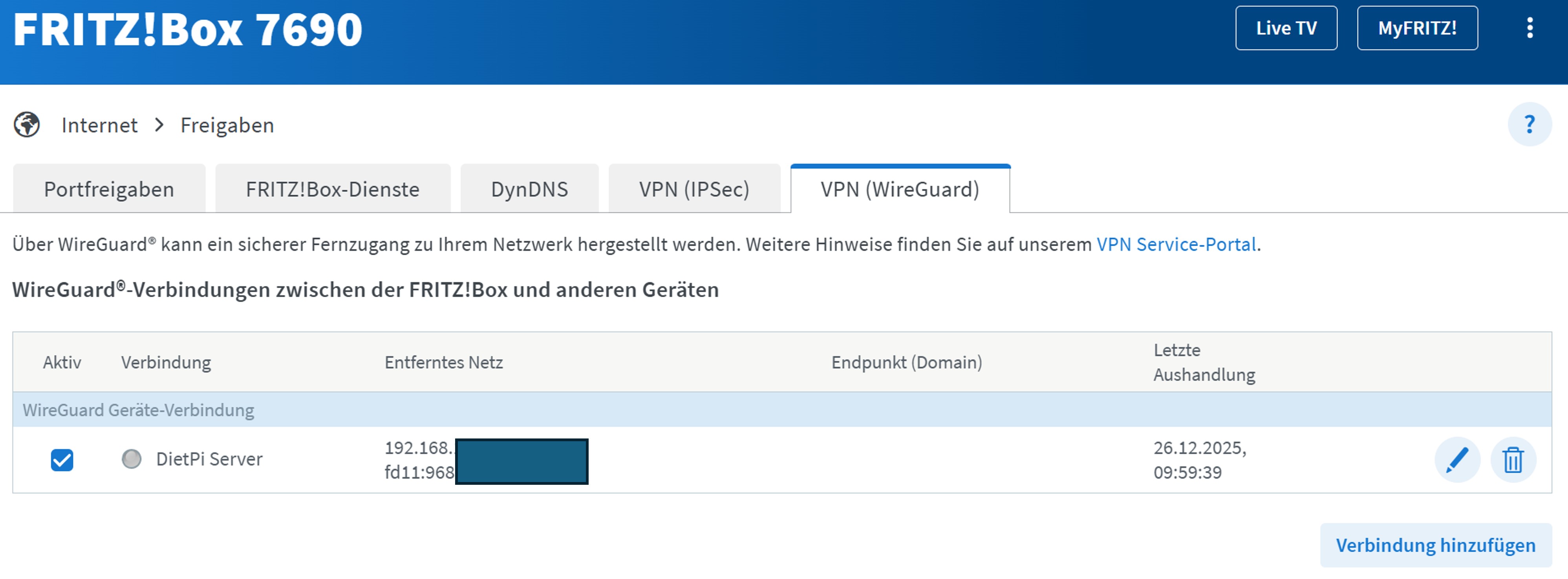

I use VPN (WireGuard) on my Router to connect with my DietPi Server where Roon is installed:
When using ARC I only have to start the WireGuard app and than ARC.
Works great - never had any problems.

I can’t tell you exactly because I use Wireguard and have set it up as Torben showed. Technically, however, the two solutions should be identical.
