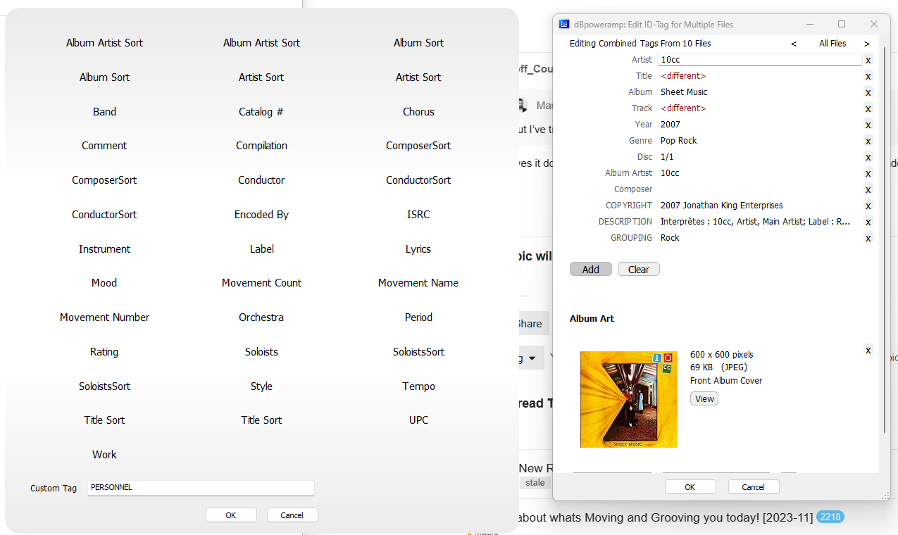

  1. How can I tag credits on my files so that Roon reads them? For example, I have a Smashing Pumpkins bootleg and I want to add a credit for Billy Corgan as the lead singer. From what I read in the two links below, I thought I had to add a field titled PERSONNEL and value “Billy Corgan - Lead Vocals”, but I’ve tried with dBpoweramp and it doesn’t work. Is that not the right way?

Er, yes it does work with dBpoweramp. You can create the PERSONNEL field and add a value to it.

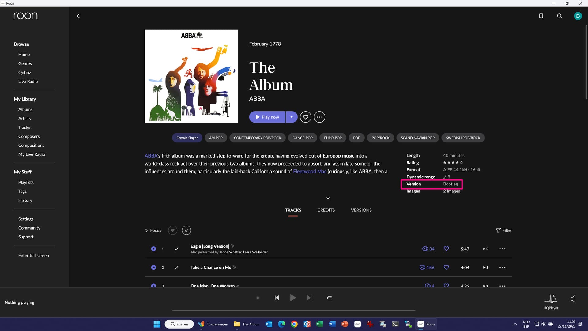

B) In my opinion, it is best to use VERSION to add your Bootleg tag.
You can do it the same way as the PERSONNEL tag in dBPoweramp
Create a custom tag VERSION and enter the value Bootleg.
Here is an example of a fake bootleg

I correct myself again. There were no issues with dBpoweramp either; it was me all along. I was adding a separate PERSONNEL tag for each credit. But it should be one single tag including a line for each credit or separated by ;. For example:
PERSONNEL
Jeff Schroeder - Guitar
Jimmy Chamberlin - Drums
OR
PERSONNEL
Jeff Schroeder - Guitar; Jimmy Chamberlin - Drums
