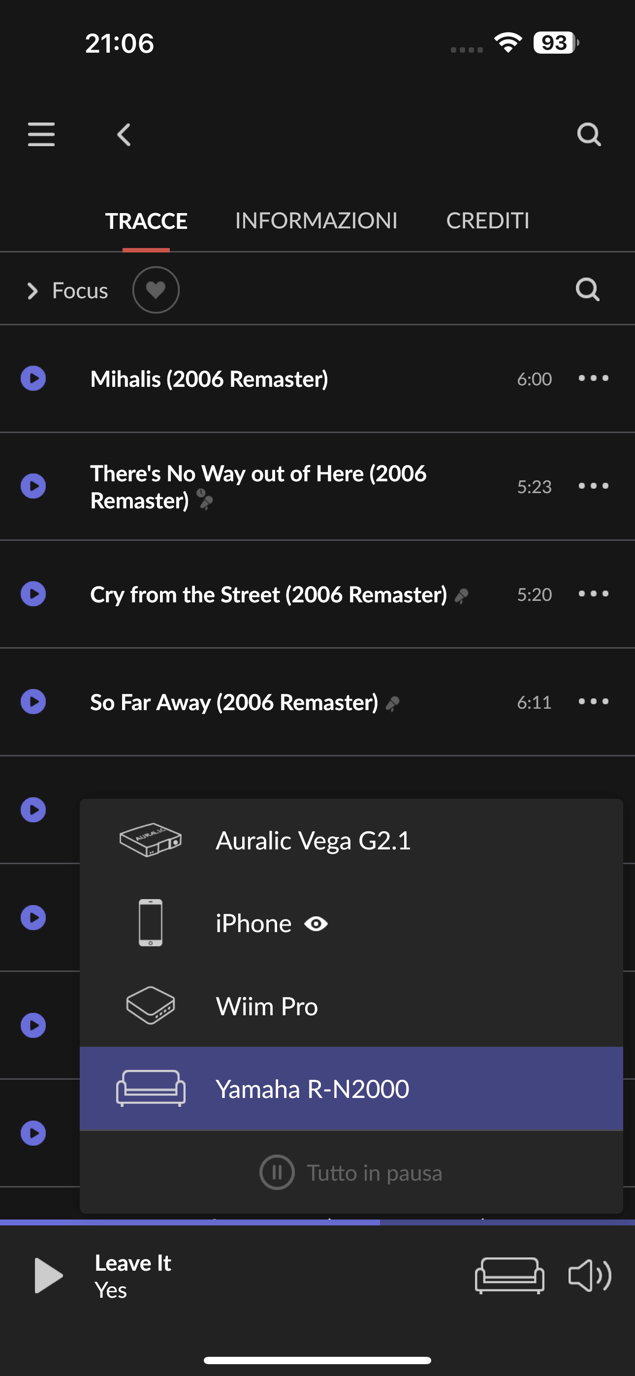

Hello guys!
Finally I can see my Yamaha on Roon. Maybe a new firmware or a Roon update…
Thanks!!!
