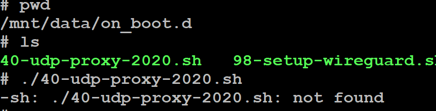

And the second thing I don’t know how to do is to run a script manually,
when I try, I get this error:
there too there must be something I’m not doing right.
If you could explain me that too?

I’m not sure why you can’t run the 40-udp-proxy-2020.sh script, it looks like your doing everything correctly.
But once you figure that out, running 40-udp-proxy-2020.sh script should create and start the container for you. After which you should see it listed when running podman ps.
That should be the only thing you need to do assuming your Wireguard setup is configured and working correctly ie. you can already see the Roon Core via the VPN even without using udp-proxy-2020.
In terms of the nano error, the UDM doesn’t come with nano installed, you’ll have to use vi instead.
But as to the wider issue of why you can’t run the 40-udp-proxy-2020.sh script, I’m equally stumped. What do you see if you run ls -a /mnt/data/on_boot.d and cat /mnt/data/on_boot.d/40-udp-proxy-2020.sh
You could also try running it like this /bin/sh /mnt/data/on_boot.d/40-udp-proxy-2020.sh but that shouldn’t be necessary, what your doing in your screenshot above looks correct.
This Stack Overflow post suggest that this can be caused by CR LF issues. Although if you just copied the download file that shouldn’t be an issue.
Maybe try cut / pasting the script directly from GitHub (click the raw button) into a new file you have created yourself, possibly outside of the on_boot.d directory for now ie. somewhere like /mnt/data/udp-proxy-2020 to see if that makes any difference.
Thanks for all this information,
I quickly tested these 2 things, and indeed there are some strange things. but I just did a factory reset though…
But you had a good intuition, apart from on_boot.d, it worked
I should be able to make it work now
Thank you so much for your help
David

I actually meant for you to run those two commands on separate lines ie.
But now you have it working outside the on_boot.d directory, you could try just making a copy of it into the on_boot.d directory ie cp /mnt/data/udp-proxy-2020/40-udp-proxy-2020.sh /mnt/data/on_boot.d/40-udp-proxy-2020.sh and seeing if you can then see / run it correctly from there.
If it still doesn’t work I’d slowly retrace your installation, specifically the udm-utilities bit under requirements and check you didn’t miss a step.
It looks like a permissions issues - I assume you’re logged in as root - but I’d be careful about changing permissions other than giving the 40-udp-proxy-2020.sh file execute permissions. Certainly don’t go charging permissions on any UDM file or directory that you didn’t create yourself.

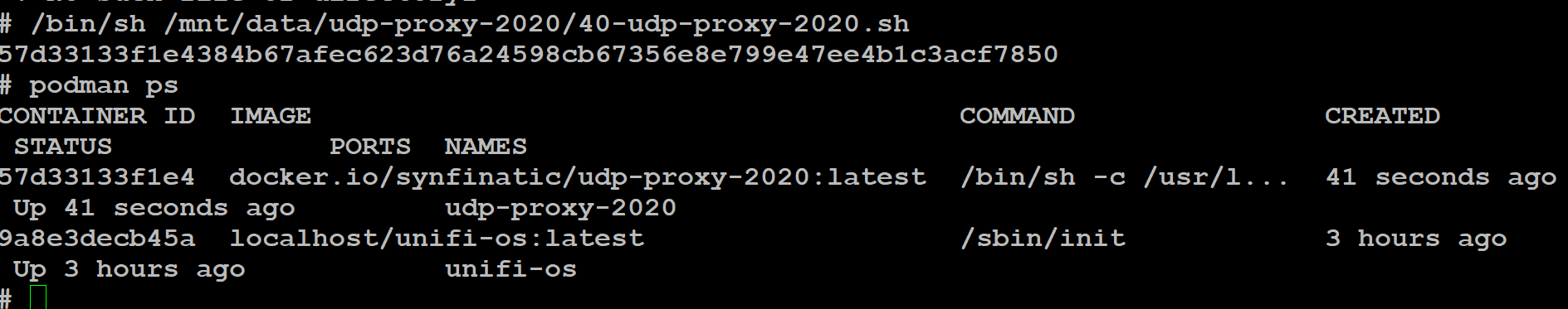

The more I test the less it works…
Now whether it’s in /mnt/data/on_boot.d/ or in /mnt/data/udp-proxy-2020/ can’t run the 40-udp-proxy-2020.sh script
Checking podman ps, only unifi os is created…
And with wireguard, I can ping my roon server, but I can’t see it anymore across roon app, however, I have configured the firewall exactly as described here: Run-a-Wireguard-VPN-server-on-UDM-Pro

I’m running UniFi OS UDM Pro 1.11.0 (latest version) so I don’t think it’s that.
When you say “can’t run the 40-udp-proxy-2020.sh script” do you meant it doesn’t run / returns an error, or just that it runs but that it then doesn’t appear as a container when running podman ps ?
If the latter I’d double check your WireGuard interface is up and running correctly.
I seem to remember hitting a similar issue and it turned out to be an issue with my Wireguard setup that was causing the udp-proxy script to run, but then fail to actually start the container, or for the container to die as soon as it was started.
Given you recently had this working, have you changed anything in your Wireguard config files? If so I’d think about what you might have changed there.
If it’s just that the script fails to run, with a ‘not found’ error like you had previously then I’m stumped, but given you recently had it working I’d think back to what might have changed.
