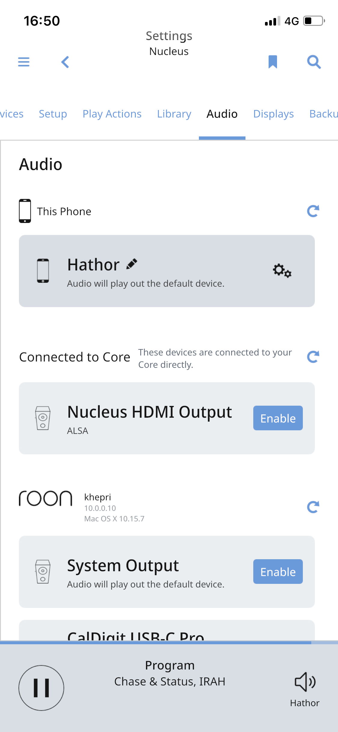

That’s it! We’re all set! Now for the moment we’ve all been waiting for, it’s finally time to see whether Roon works over WireGuard VPN:
- Disconnect the client from the local network (e.g disable wifi on your phone)
- Turn on WireGuard VPN on the client (e.g. flip the VPN switch on your phone)
- Open up Roon Remote and see whether it can find your Core and stream to the client
Pics or it didn’t happen:
