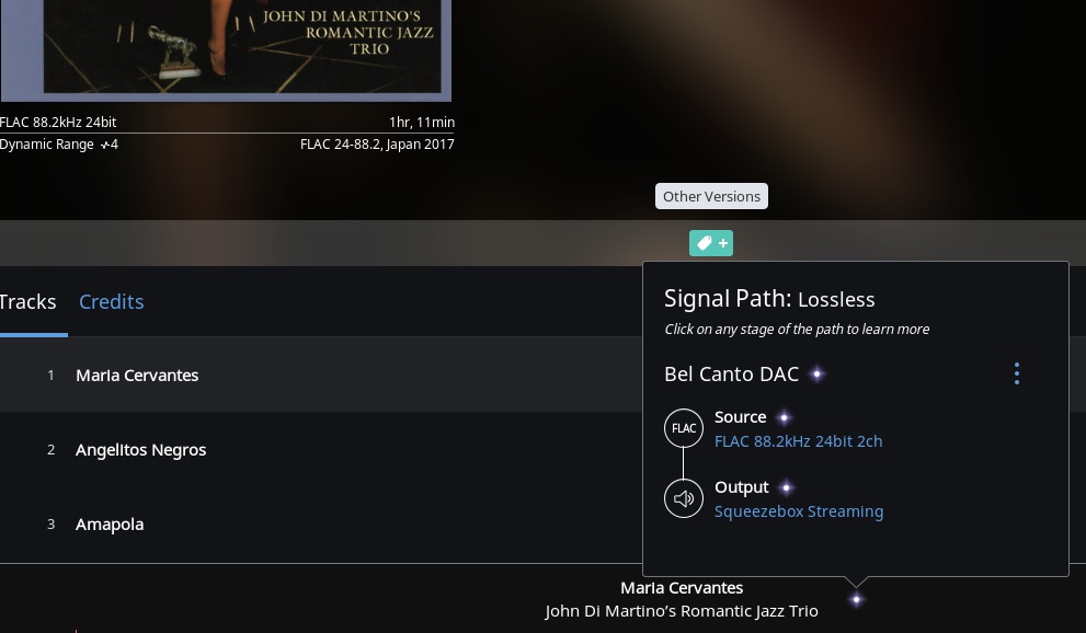

Thanks, @orgel for the advice. I went with custom, as you’ll see in the first attached screenshot. But, when I play out any music, I’m still getting lossless – not enhanced to show that I’m upsampling. See second screenshot for example of a 24/88.2 file not being upsampled as it should be.
Thoughts on what I am doing wrong? Thanks. JCR
In the DSP Engine dialog, hit the “master switch” at top left so that the DSP engine is enabled.
Ahem, missed the forest for the trees there. Yup, why did it. Thanks. JCR
