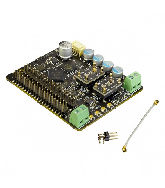

Actually I left out to mention i have an Ian Canada FIFOPI reclocker between my PC and the Pontus.
With 2 Accusilicon Clocks … Perhaps that’s why it’s playing 48khz with no problem.
