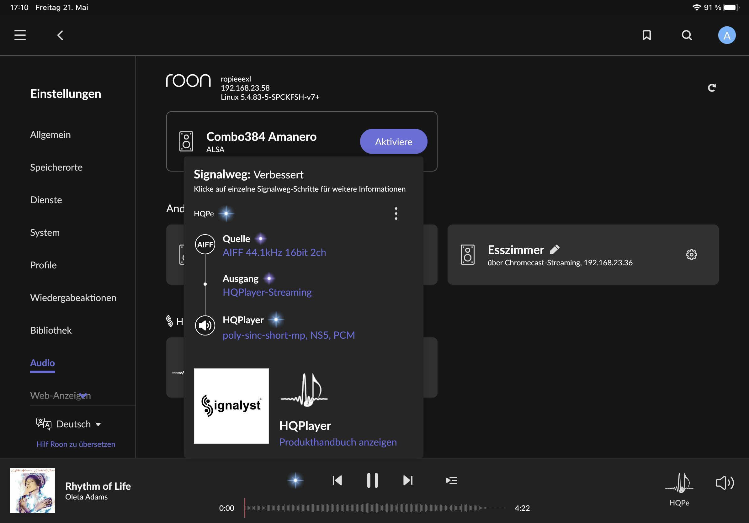

Both are on the same machine, I selected ‚localhost‘ in Roon as the IP address for HQPe, tried as well the fixed IP address of the server. Currentlx, I assume a conflict with the output device. Roon and HQPe has both the RopieeeXL endpoint.
Yeah. Disable the Roon output device in Roon while you are using it as an HQP NAA.
I disabled the output device in Roon, but unfortunately the playback doesn‘t start using the HQPe zone. The log file shows the following error message at the bottom:

Any ideas what to try out? Roon signal path looks ok.
