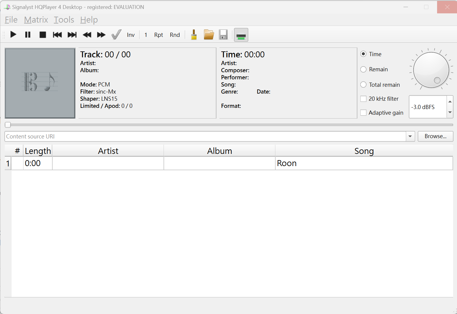

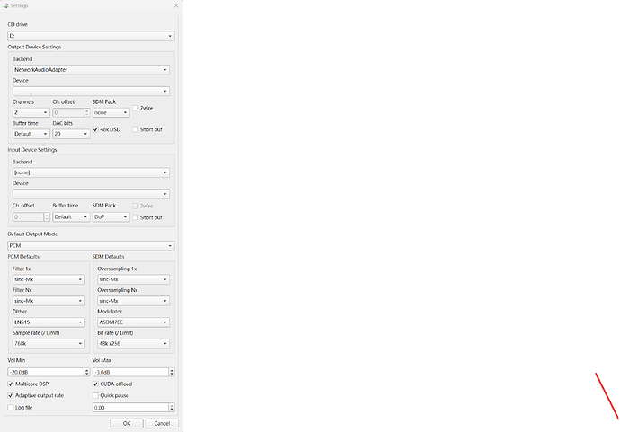

HQP cannot detect streamer (again)
Roon is working fine with direct streaming to streamer but not cannot play via HQP.
Could i ask any tricks to make it work ?
I have been trying firewall setting off and on, allowing all traffics, but still HQP cannot detect.

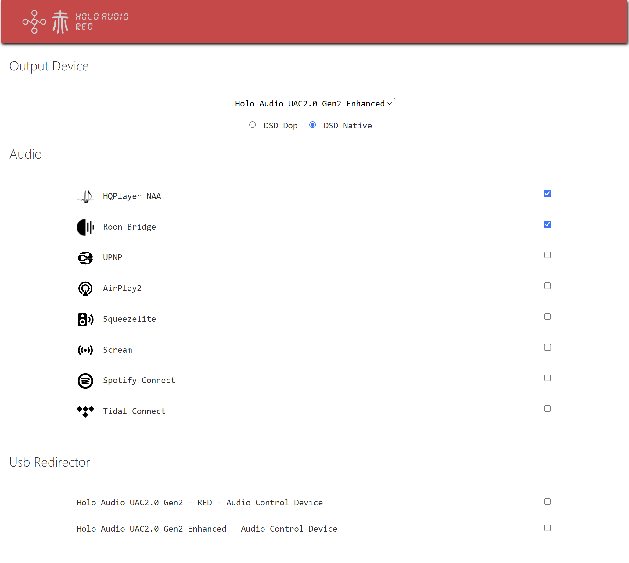

Roon <–> Holo Audio Red Streamer <–> Holo Audio May Dac (all under same subnet network)

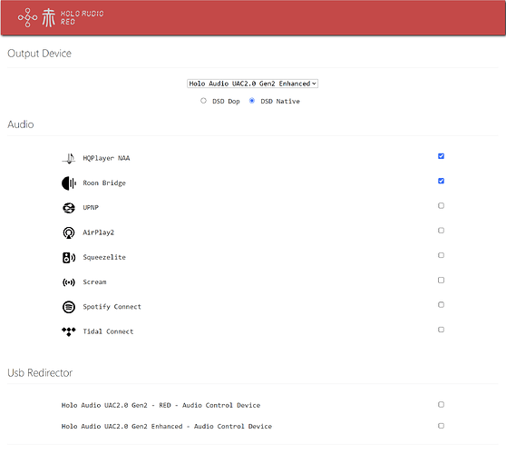

Problem is likely that you have booth Roon Bridge and NAA enabled simultaneously. Especially if you have the output also enabled under Roon β†’ Settings β†’ Audio. Remember to disable the output there!
If you have Roon Core running, it will steal the audio device and HQPlayer cannot access it anymore.
If you have a spare microSD of at least 4 GB, try flashing NAA OS v4.3.1 on it and boot it up on Holo Red.

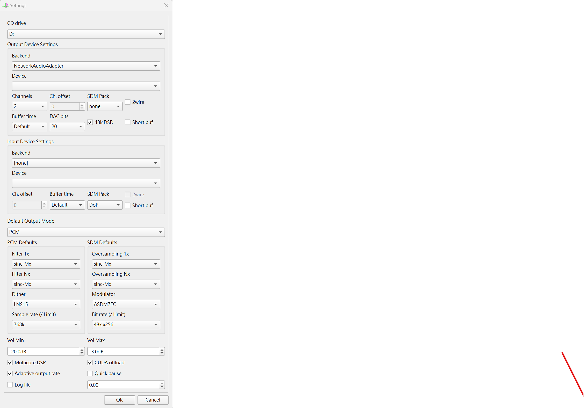

thank you for reply. Indeed i have tried HQP NAA enable only, still streamer/dac cannot be detected under HQP.
I will try NAA OS v4.3.1 flashing on another microSD and boot it up on Holo Red.
apologies to HQP, found out it’s the VPN software installed a TAP windows adapter ethernet connection affecting the network connection. Once stopped it, HQP can detect streamer without any problem.
